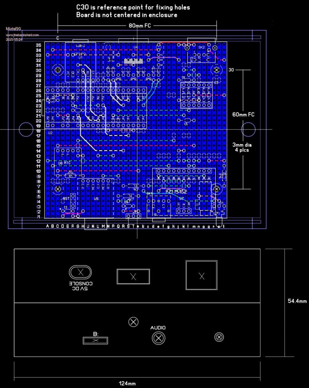

Just my take on a design. This one fits the RM2015S case from Hammond, so it can look rather nice (and even dust-free!). This case can be found for about £3.79 + postage here in the UK (Rapid Electronics). so it's probably hardly worth 3D printing one.
This hasn't been easy to test on SL6, but it does seem to work ok if I swap the strips for normal traces and put the links on proper trace layers.
Note, this uses the Adafruit module for the HDMI connector as there's no other realistic alternative. If you intend to build this get that first. It also uses the "inverted" micro SD card module as that fits the track layout better than most. You may be able to find this without the pins ready soldered, in which case fit them from the socket side.
info.pdf
circuit.pdf

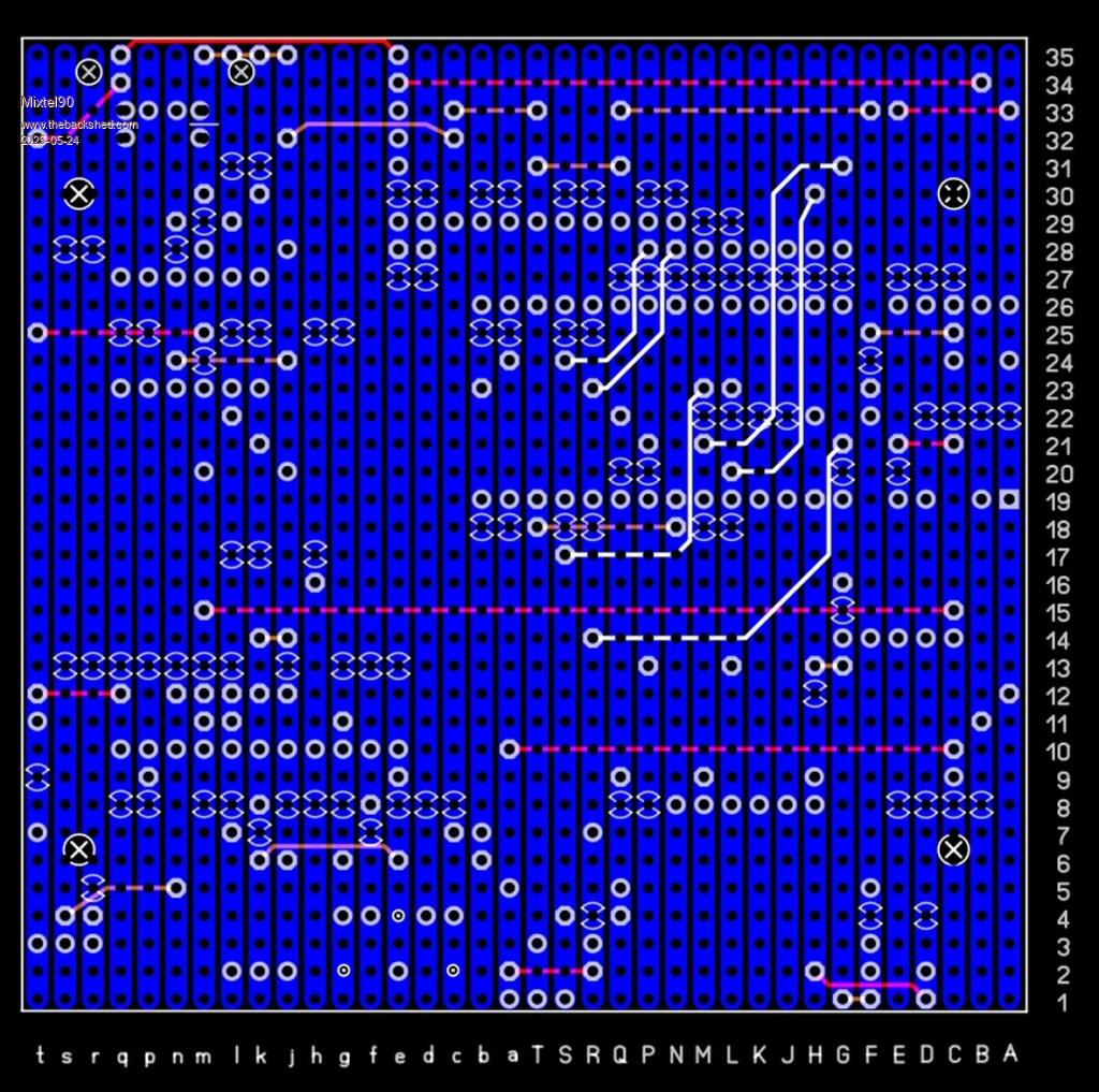

Have you got a solution, how to cut the traces best?
And the cuts are hard to see in the drawing, could you mark them e.g. in red?

Posted: 12:10pm
24 May 2025
This might help. It's a view of the copper side of the board with most of the other stuff removed. You really need the other picture too.

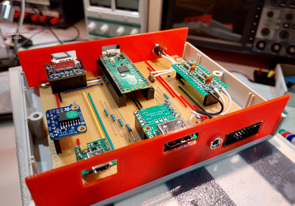

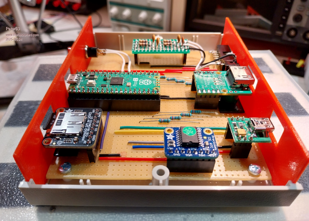

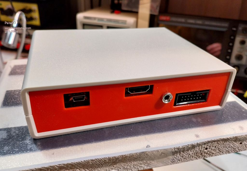

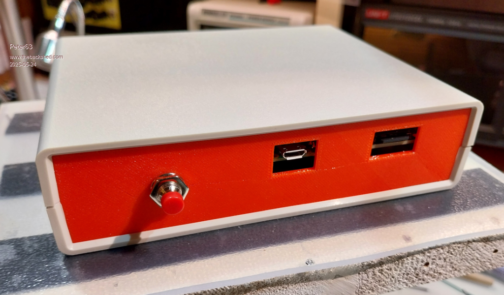

Posted: 12:42pm
24 May 2025
Peter63
Hello
This is how I built my own HDMI version some time ago. Maybe you can get some ideas for your own building. Case is G738 from Velleman
/Peter63
Posted: 03:30pm
24 May 2025
Very nice, Peter, and very red! :) It looks like you might have used pad board? I was being deliberately awkward and restricting myself to a relatively easily available size of ordinary stripboard and the cheapest decent enclosure I could get. It was just for the challenge. :)
