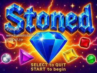

Posted: 07:24pm
10 Jul 2026
Stoned
A new game for Game*Mite only. See previous post how to get it.
This is a port of the merge game "bejeweled". You have to bring together 3 or more identical stones in a row or column.
You move around using the D-pad. A selects a stone to move. B provides a hint (there are only 10 allowed).
SELECT brings up the menu, START starts the game.
You have 5 minutes to get the highest score and beat my 2900... Note point per stone are progressive. A row of 5 scores far more than 2 rows of 3.
Happy gaming
P.S. this game has no animations, it put's everything graphics directly on the LCD, so the game could be developed in high color depth. It looks great.
P.P.S. all graphic elements where developed in higher resolution, and scaled down. So it is possible to make a version that uses high colordepth on HDMI, and higher resolution. But for that to happen, I first need an HDMI setup.
