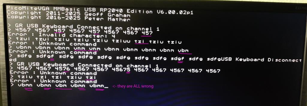

Same problem, but to be sure I generated the MD5 checksum, so that you can compare the version:
Md5 Checksum online tool: https://emn178.github.io/online-tools/md5_checksum.html
It gives me "3971224a263653cd6881573a34df4d7a" for your file.
Here sadly the same problems, new image:

Please just run a single finger across vbnm as fast as possible - what happens?

Posted: 02:56pm
07 Jul 2025
Amnesie
Ok done.
With a single finger I wasn't able to produce any false chars or missing or swapped chars. Then I tried to write in my maximum speed in german and english (a bit slower), here I can't replicate any of the mentioned "problems". It only appears if there is rollover involved. And this (rollover?) problem with the group of "VBNM" starts really quickly, I must not type fast that the problem occurs. But what (for me counts) I wasn't able to re-create any of the mentioned problems with normal writing.
Before your fixes, I wasn't able to write the word "save" for example. Now with an english text and some keywords I tested, the problem isn't re-producable under normal circumstances. So for me, as said a few post ago, absolutly usable now. Although the problems persist under the mentioned circumstances, I think we have to live with that - which is fine because:
only a few people have those problems
and as it is now with the fixes, it is even for me highly unlikely that I run into problems again.
So I think further fixes will be just for sports (is it even called this way in english?)

That doesn't work because as we have proved in an earlier test version it creates duplicates as a key can appear both before and after the error code.
Even with a 1mSec scan it is perfectly possible for two keys to be pressed and the order in the array ought to indicate their order but again, the evidence from the difference between Amnesie's keyboards and mine is that they seem to report in the opposite order.
Currently it seems like the last version last night is the best with the only issue that after a 0x010101010101 Amnesie sees a swapped pair of characters. I don't.
