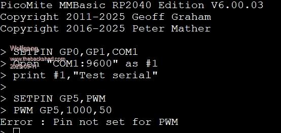

Hello user,
I'm a litte bit confused, because I can't manage to generate a PWM, see listing. What am I doing wrong?
The serial output is working, but PWM inputs produce an error
I tried other GP-Pins too, but no success.
Greets Wolfgang

matherp Guru
See Manual page 11 then Manual page 149

Volhout Guru
Hi Wolfgang,
PWM's on the RP2040(and RP2350) come in pairs. For each PWM block there is a A output and a B output. Look at the pinout of the Pico in the user manual. The commands in MMBasic have parameters for the A and B output separate. When not using the A output, you can leave the A parameter blank.

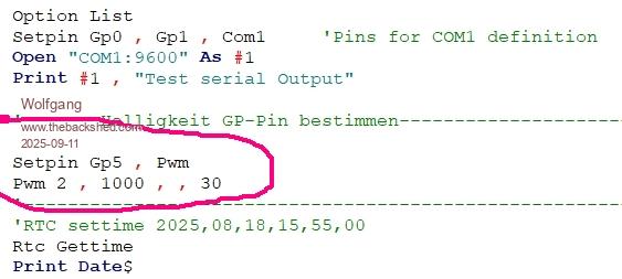

Wolfgang Newbie
Many thanks,
the little detail named "double-comma" solved the problem. it works now, see picture: I hope I understand this right.
As a newcomer, I searched before through many forum posts and the manual too, to find information or examples about PWM settings, but I couldn't find an example that showed a double-comma setting before the duty cycle value.

In order to use the PWM, (e.g. GP4/GP5)
SETPIN GP4,PWM 'Channel 2 with Duty A=30% SETPIN GP5,PWM 'Channel 2 with Duty B=50%
PWM 2,1000,30,50
Is this understanding correct?
Greets Wolfgang
Posted: 07:24pm 11 Sep 2025 Copy link to clipboard
Volhout Guru
Correct, the PWM runs at 1kHz for both channels.
