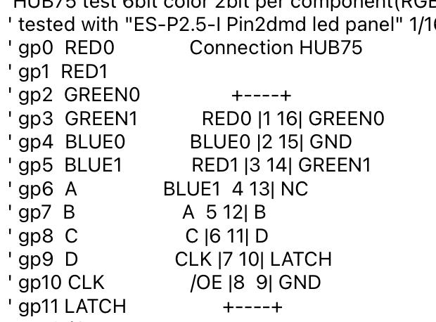

Posted: 01:38am
27 Sep 2025
The comments at the start of his code show its socket pins and the model to search for.
'HUB75 test 6bit color 2bit per component(RGB)and some fill bits = 1byte      |
' tested with "ES-P2.5-I Pin2dmd led panel" 1/16 scan from Ali-Express
' gp0  RED0              Connection HUB75
' gp1  RED1
' gp2  GREEN0                 +----+
' gp3  GREEN1            RED0 |1 16| GREEN0
' gp4  BLUE0            BLUE0 |2 15| GND
' gp5  BLUE1             RED1 |3 14| GREEN1
' gp6  A                BLUE1  4 13| NC
' gp7  B                    A  5 12| B
' gp8  C                    C |6 11| D
' gp9  D                  CLK |7 10| LATCH
' gp10 CLK                /OE |8  9| GND
' gp11 LATCH                  +----+
' gp12 /OE
' The reduction to only 6bit was usefull to minimize the time for preparing
' display-data (pack and mix now~1ms), The PIO would be quick enough for more!
Posted: 01:53am
27 Sep 2025
Hi Phil,
Thank you,
That makes sense, I read the bas file on my iPad and the screen looked like this.
Which wasn’t obvious as a pinout.. your view is very clear.

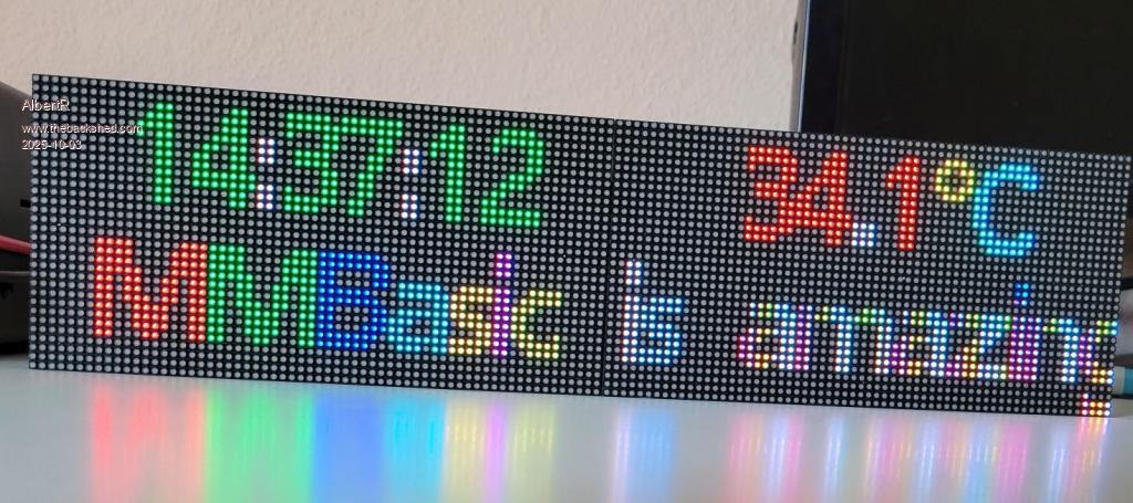

Posted: 12:48pm
03 Oct 2025
AlbertR
I think the last version.
The Hub75-PIO is unchanged, only the application is expanded to show what is possible with MMBasic.
If the fantastic math and memory functions are used, you get really useful results, still without the need of CFunctions.
Hub75TwoLines.zip
Albert

Posted: 01:33pm
03 Oct 2025
Hi Albert,
That is a thing of beauty..
I am still procrastinating over buying a couple of screens, every place I look want more for postage than the screens themselves.
What is your estimation of the maximum number of pixels that can be supported before either mmbasic reaches its useful limits?
Posted: 02:29pm
03 Oct 2025
AlbertR
The shown display are two of the 'ES-P2.5-I Pin2dmd' led panel. As shown in the name it has a 2.5mm Pitch, with 128x32 pixel -> 320mmx80mm.
How many pixels can be displayed usefully by MMBasic?
That is a question what you want. The PIO is extremely fast, also the displays. In the first demo I draw 500 rectangles a second and the displayrefreshrate, the PIO show pixeldata 3 times for the differnt bits of the color, was 600Hz @ 9.7MHz of the PIO. To reduce flicker in the video, I increase that some times to 60MHz. The PIO is not the bottleneck. That seems to be the memory and the calculationtime for the data.
At the moment I use an integer for every pixel. This is useful in order to be able to use the math-functions. They are much faster then loops where you calculate one by one pixel. Unfortunately there are no Byte-Arrays.
Do you want more layer to program an background to move over or a grid in the front, you need the display-memory doubled or tripled.
How many updates are needed a second. In my application the displaydata for the PIO is double buffered for output. Ones calculated, it will be displayed as long as the PIO run. This contains only 3 bytes for 2 pixel.
But you will display changing data i thing.
The preparing for 4096pixel(128x32) takes about 1.7ms with a RP2350  @200MHz. This must be done after new data are filed in the Work-Array.
I think 128x128 pixel are possible if not all content is complely new arranged. Scroll by only moving the screen could be more.
Albert

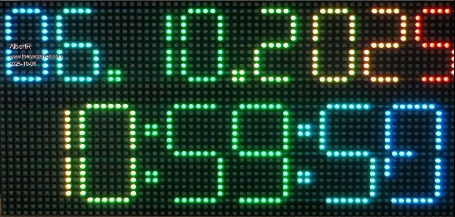

Posted: 09:56am
06 Oct 2025
AlbertR
This time a little smaler,
a first little application, or usefull demo for the display-driver (32x64) and only 6bit color.
Inspired by the "Morphing Clock" for this Hub75-panels, I ported it to MMBasic. I have no idea if this has ever been done before.
The animation is not from me, see header in the source. I only changed the code from C and adapt it to my display driver. Very simple and not optimized, I thing for playing with it.
MorphClock.zip
Albert
Posted: 09:58am
06 Oct 2025
Nice !!! I like animations...
