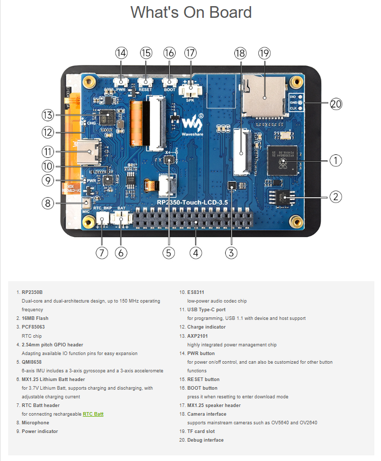

  Quote  It seems to be a problem with the RTC-chip implemented to the board (that mmBasic officially does not support)
The issue may not only be writing the year to the RTC but also reading it back with RTC GETTIME if it is using different registers to the regular RTCs.
I guess there are a number of ways forward.
1) As the months and days appear ok the easiest and crudest method is to substitute the correct year at bootup with something like:-
Sub MM.STARTUP
  RTC GETTIME
  Date$ = Left$(Date$,6) + "2025"
End Sub
  Quote  The command OPTION RTC AUTO ENABLE can also be used to set an automatic update of the TIME$ and DATE$ read only variables from the real time clock chip on boot and every hour.
So to avoid the year being overwritten don't use OPTION RTC AUTO ENABLE.
2) The Waveshare example programs presumably manage to set the PCF85063A RTC correctly so see if you can convert that section to MMBasic Subs for writing and reading the chip.
3) From the PCF85063A datasheet create your own RTC Subs.
4) If enough people use this chip perhaps it can be added to the firmware.

Again, a lot of help from this forum. I bought 2 WaveShare RP2350-Touch-LCD-3.5 units for a project.
https://docs.waveshare.com/RP2350-Touch-LCD-3.5
I discovered that the RTC chip was PCF85063A, which didn't work with PicoMite's built-in RTC functions.
I searched for PCF85063A on this forum and found a solution.
I might especially have to thank phil99 and Arne for this, of course everyone else who helped as well.
