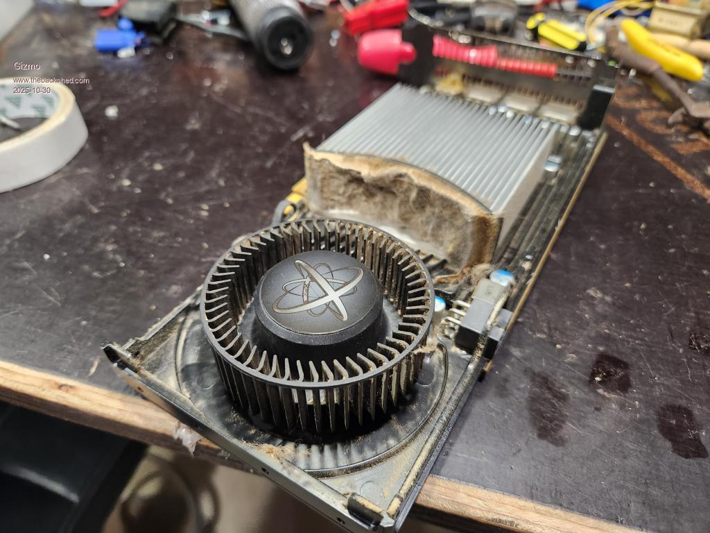

Brought it home, swapped out the NVidia 660Ti with the new graphics card. Booted into Windows and installed drivers for the AMD card. Noticed the fan on the AMD card was very loud. While testing in windows I got a message about the GPU running hot, and then it shut down. Pulled the card, off to the workbench we go. Removed the cover, and saw the heatsink was clogged up with fluff, almost like it was a carpet.
I cleaned it out, used some compressed air and paint brush. Then removed the heatsink and put on some fresh heat transfer grease. Back together and back in the PC, its now working properly, I can barely hear the fan.
