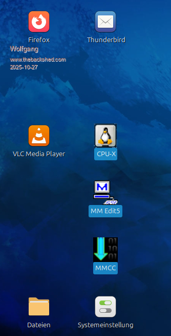

Wolfgang
@Tassy-Jim
basically I wanted to say goodbye to Windows and have made MMedit accessible on Linux Mint with an icon from the desktop.
I wrote a small routine with Linux MMedit to test it, but I can't manage to set the correct port to start the program with MMbasic
In MMedit I only see COM-ports from 0 -31, but none of them have an ending that indicates the connected USB port.
The Test-program fully works under Windows.
And Perplexity delivers no solution, can you help?

Posted: 09:03pm
26 Oct 2025
@Wolfgang,
There are many different versions of Linux and many different ways of doing things.
I do not know enough about all the differences to help much.
I produced MMEdit on Linux Mint Mate 20.4
To make MMEdit run it needed extra files.
You ran
sudo apt-get install qt5-default libqt5webkit5
Not all the files required were installed
so you ran (hopefully)
sudo apt-get install qtbase5-dev
That should have installed the remaining required files.
When Linux Mint was updated, the files needed where no longer available so you had to try the second method.
That should have installed the extra files needed and they should now be installed.
The ZIP file you downloaded includes 3 install files
MMedit5_32_64.exe for normal Windows installation
MMEdit5_XP_portable.zip to make a portable installation for Windows.
and
mmedit5_20.4.tar.gz for Linux
tar.gz files are just like ZIP files.
When you clicked on MMedit5_32_64.exe Wine started and installed MMEdit Windows version under Wine.
That is OK but I find that the serial ports which we need work better when controlled directly, not through Wine.
Someone else who knows how to use Wine will have to help you with the serial ports.
To install the Linux version of MMEdit, extract the files in mmedit5_20.4.tar.gz and put then in  a suitable location.
Every one has a different opinion about where to use but i used my "Home" folder
I have
Jim \ MMedit5
then from your file browser, open that folder and double click on MMedit5 or MMCC to run the programs.
I will let someone who knows how to create the desktop shortcuts for you version of Linux help you with that step.
Your picomites will appear as ttyACM0 or ttyUSB0 etc depending on what method you use to connect to the picomite.
I hope that helps.

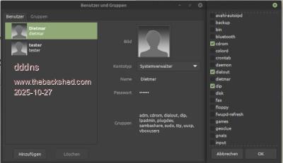

Posted: 09:47pm
26 Oct 2025
dddns
  TassyJim said
  Quote  If you have the 22.4 kernel, you may need to run this:
@Wolfgang
The Qt libraries are essential. The above command must execute without error.
And in order to be able to connect to a PicoMite your username must be in the group "Dialout".
Go to "users and groups" in your system management folder and add your username to Dialout:
Edited 2025-10-27 07:50 by dddns
