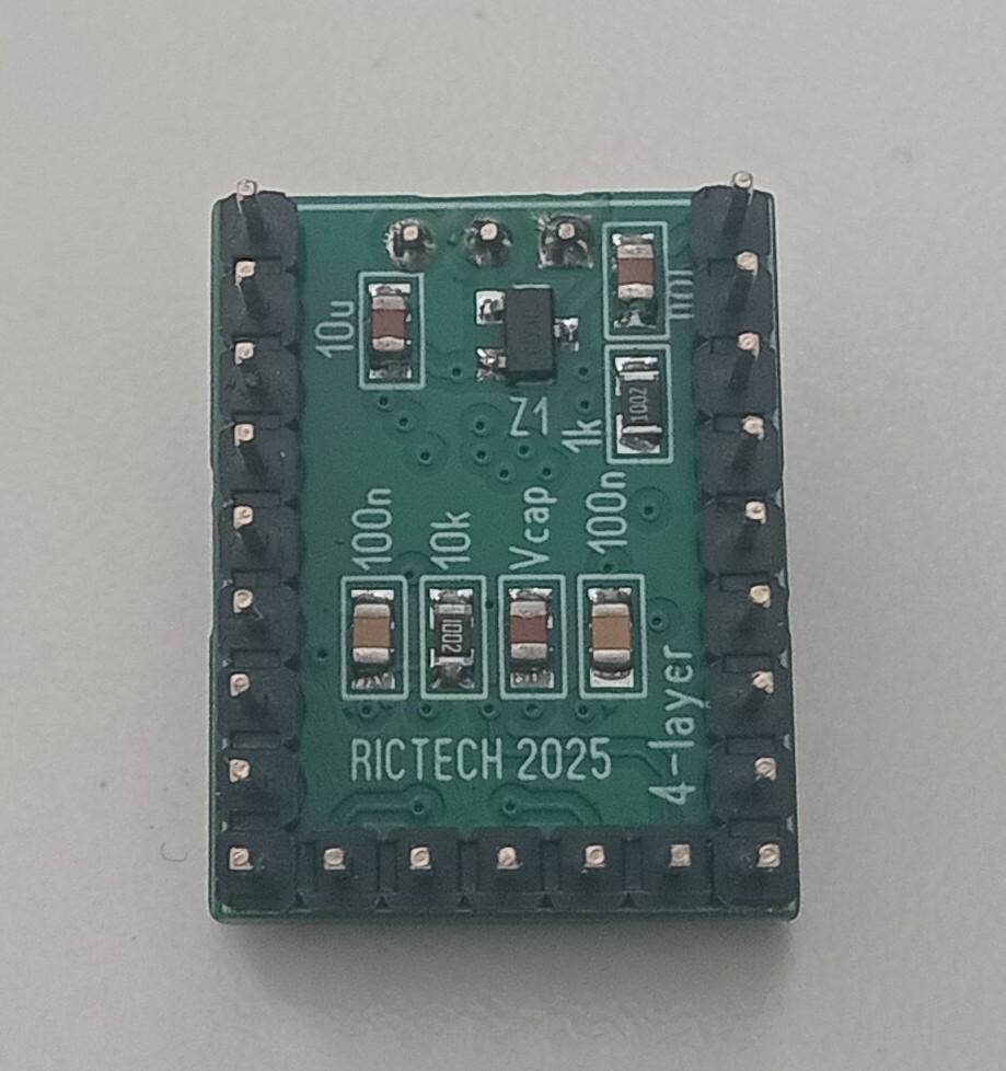

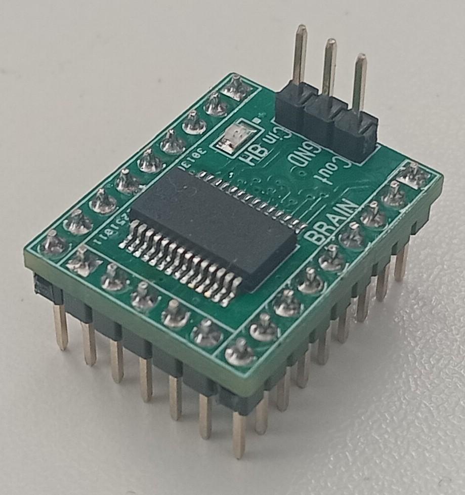

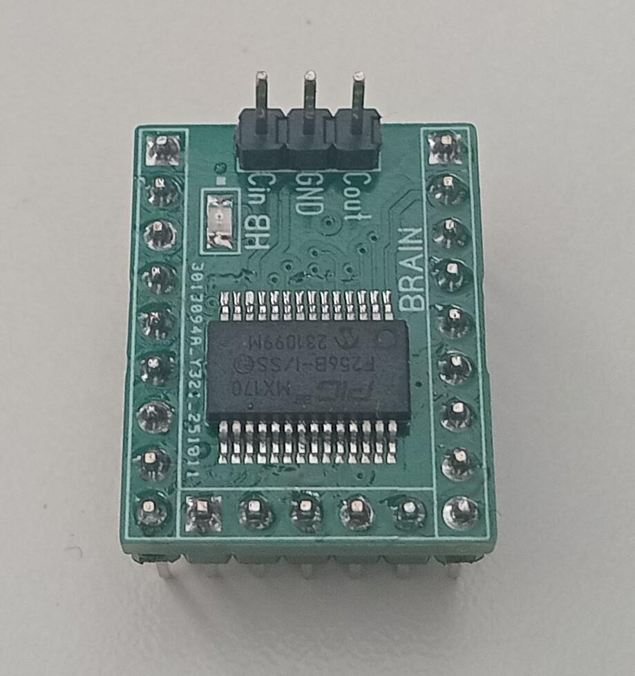

Following on from my other thread about Watchdog problems when using the WS Zero module and the PM firmware, I hereby show-off my version of this module.
The footprint is exactly the same, but the I/O numbers are different.

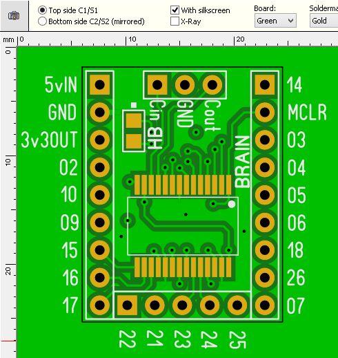

This new design is based on the classic MM2 chip, that being the PIC32MX170F256B, and is programmed and used in exactly the same way.
Certain I/O pins on the 170, needed to be on certain pins on the footprint, which is why the pin numbers are a bit all over the place. This board is 4-layer.  Not possible to do on two layer with the size restriction.
See my other thread for reasons as to why this came about.
I will be getting a few of these made, so if anyone is interested....
