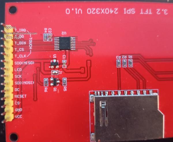

Hello,
I remember there was a discussion how this issue could be solved
by modifying the circuit. Something with removing a diode and adding a bridge/resistor.
But I cannot remember what exactly there is to do.
Would somebody who knows please help me or point me to the discussion?
Many thanks!
Posted: 12:13pm
27 Oct 2025
no mod needed for the ili9341. The mod applies to the ili9488
Posted: 12:17pm
27 Oct 2025
Hi dddns,
Look at U2, there is something between pin 7 and 8. A short ?
Posted: 12:37pm
27 Oct 2025
dddns
  Volhout said  Hi dddns,
Thank you for answers.
@Volhout
After I posted the picture I saw it for the first time. Even with two reading glasses as sandwich this was not visible to me.
I will give an update

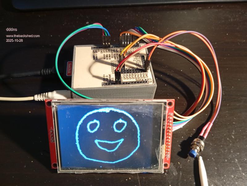

Posted: 09:29am
28 Oct 2025
dddns
I got it :)
it was a bumpy ride but finally everything is working.
First there was this short and another electrical issue.
And then a longer journey to find a pin assignment which works with all devices.
Touch was not possible to get to run clean as use this config, e.g Option touch gp20,gp21 wold not work. Having system spi on gp22,gp23,gp20 doesn't work either.
But no problem, this is working:
PicoMite MMBasic USB RP2350B Edition V6.01.00RC9
OPTION SYSTEM SPI GP2,GP3,GP0
OPTION LCD SPI GP14,GP15,GP12
OPTION SYSTEM I2C GP4,GP5
OPTION FLASH SIZE 16777216
OPTION COLOURCODE ON
OPTION KEYBOARD US, 0, 0, 150, 50
OPTION PICO OFF
OPTION CPUSPEED (KHz) 378000
OPTION LCDPANEL CONSOLE 7,,, 50
OPTION DISPLAY 30, 53
OPTION LCDPANEL ILI9341BUFF, LANDSCAPE,GP16,GP17,GP18,GP19
OPTION LCD BACKLIGHT 50
OPTION TOUCH GP26,GP27
GUI CALIBRATE 0, 3984, 3772, -869, -639
OPTION SDCARD GP10
OPTION KEYBOARD REPEAT 150,50
OPTION AUDIO GP6,GP7', ON PWM CHANNEL 3
OPTION RTC AUTO ENABLE
OPTION DEFAULT FONT 7, 1
OPTION PSRAM PIN GP47
