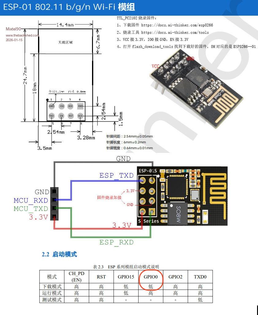

Completely untested, but ESP8266-01S using the stock firmware is a serial transceiver module that connects via wifi. It connects to a COM port using RX and TX lines and is driven using AT+ commands, similar to modems. It might be worth investigating as it's very cheap and easy to find. Remember to put a 100uF capacitor directly across its supply pins.

All you need is the command list for the ESP8266-01S.
I don't use KiCAD so I've no footprint for it, but the module is a simple 2x4 0.1" female header.
As I mentioned, fit a capacitor on the supply rail. Link EN to 3V3 to keep the module enabled.

Don't get into a knot with the ESP8266-01S. It isn't a ESP32 and doesn't have those capabilities. In this instance it's a simple com port to com port wireless link that happens to be at 2.4GHz and use AT+ commands to control it. There are no GPIO pins used on it (it only has 2 anyway, IO0 and IO2). Very much like using a modem.
I advise setting the TX power very low while you are experimenting. :)
