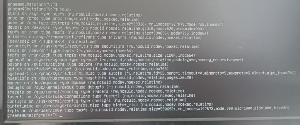

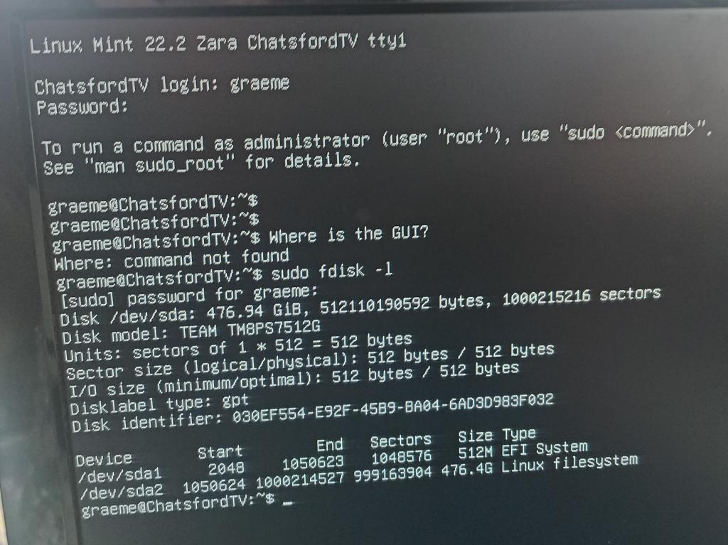

This is what I am seeing when I boot up:
It's upset, cos it says it is in "Emergency mode"
I type "login", and log into the account I created for this machine. At that point, I am stuck.
Anyone got any pointers as to perhaps a command I need to type or a config file I need to edit to get things booting again?
Posted: 11:30pm 17 Jan 2026 Copy link to clipboard
dddns Guru
Your root partition could not be mounted. Boot with a live stick and this will show you all UUID's:
blkid
Then click on /dev/sda2/ with the filemanager and navigate to /etc. Open it as administrator and edit /etc/fstab
Look in the first line with "/" and enter the UUDI you saw with blkid above for /dev/sda2
save it and reboot
Hope that helps :) Edited 2026-01-18 09:31 by dddns
Posted: 11:53pm 17 Jan 2026 Copy link to clipboard
dddns Guru
The second pic is confusing, what is the output of
mount
