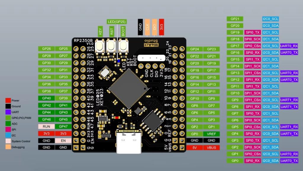

This looks like a good base for projects which don't try to replicate Peter's excellent 64-pin DIL PCB.
With the USB connector down, the right 2 rows of pins effectively replicate the Pico 1 pins, with their respective functions.

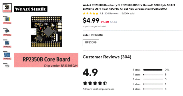

$4.99USD if 3 purchased from Aliexpress:

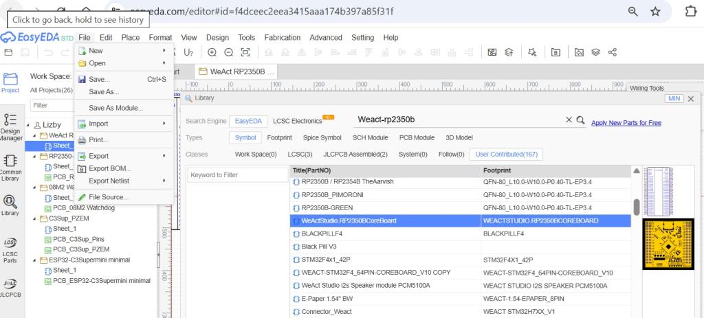

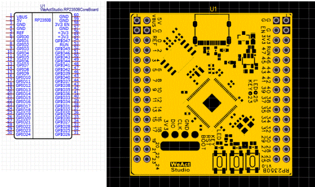

The EasyCad footprint is available in the Standard (not Pro) version under "User Contributed" as WeActStudio.RP2350BCoreBoard (I couldn't find it under Pro):
In EasyCAD:

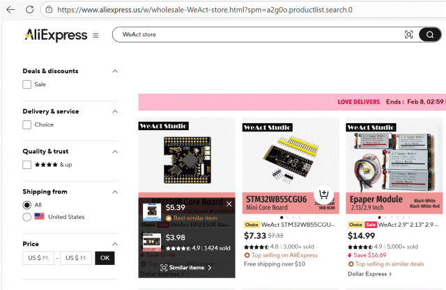

I'm getting a "Love Delivers" page, not a WeAct page. It lists several WeAct items but they are all STM32, CANFD, Mini Debugger and ESP32. Not much WeAct and no WeAct RP stuff at all.
Posted: 04:16pm
05 Feb 2026
  Mixtel90 said  I'm getting a "Love Delivers" page, not a WeAct page. It lists several WeAct items but they are all STM32, CANFD, Mini Debugger and ESP32. Not much WeAct and no WeAct RP stuff at all.
Yes, the page I get is "Love Delivers", but the RP2350 is the upper leftmost item:
If I click on that, I get the "Dollar Express" page which also has the module (among others), and if I click on that, I can order it.

I've just looked again (waterfox browser) and top left is the Epaper module. :)
