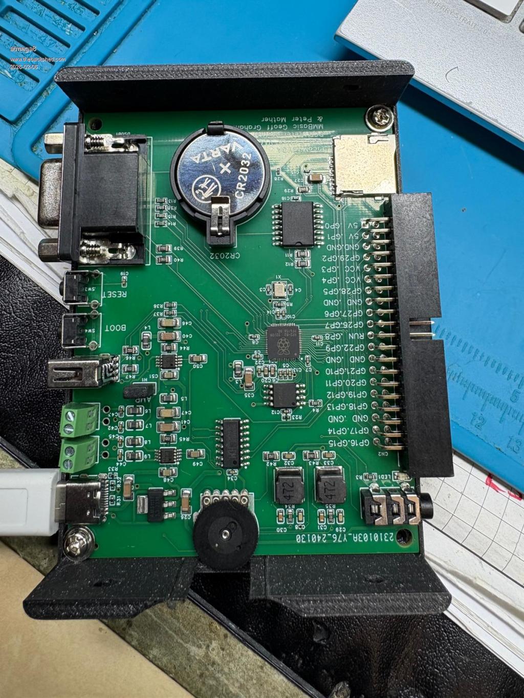

Hallo,
which USB Port should i connect to power it on, USB C or USB A?
Which Button to Press when Flash?
Boot or Reset?
The Device doesn't show up in my Explorer to copy the Binary on it.
RED on board LED is blinking.
THX
Posted: 05:42pm
05 Feb 2026
A to program. C to use at which point the A becomes a USB host. Use the VGAUSB firmware.
