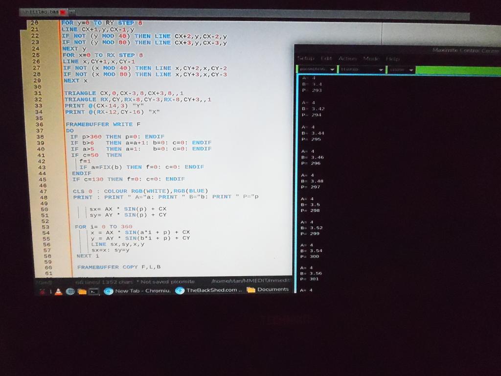

I've got a RPi 4 on 64bit trixie and installed your mmedit5_rpi.
MMedit seems to work, but I've problems with MMCC, it doesn't accept <Return> and <Ctrl>-<C> and hangs quiet often.
Perhaps I missed something.
Greetings from the upside of our beautiful planet,
Martin

There’s no difference between <Return> and <Enter> (i.e. between the alphanumeric and numeric keypads), and it doesn’t matter whether I access the RPi locally or via TigerVNC (which I usually use).
So I use <ESC>, <^C> and <Send+CR> via the menu; that works.
(Yes, ESC is one of the ‘naughty’ keys too)
The great thing is:
Data transfer from MMedit via MMCC to the Pico is working well – that’s the most important thing.
(Unfortunately, it’s not currently working between MMedit on Windows and my CMM2, but that’s probably a different matter)
