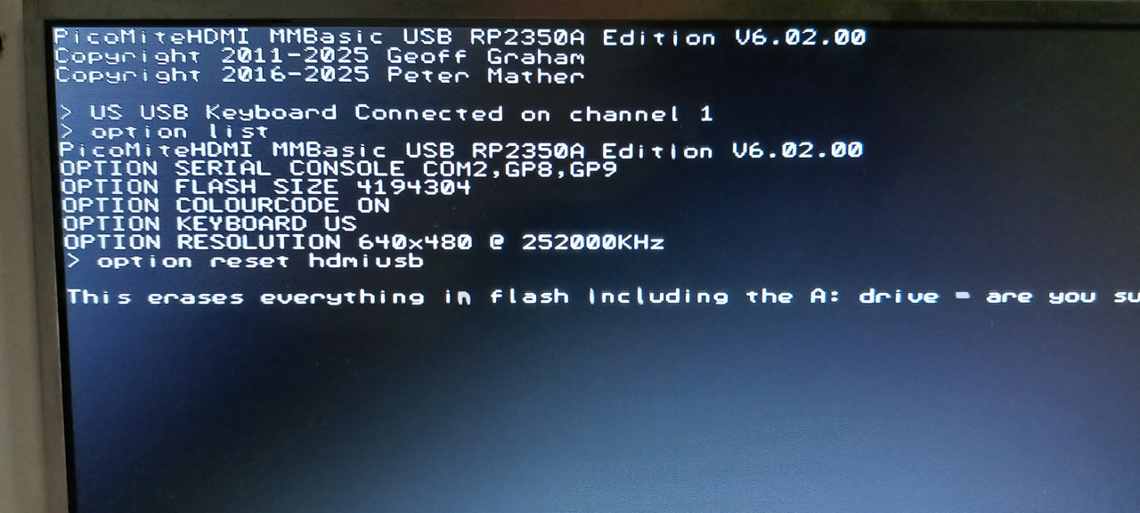

  tenij000 said  > option list
PicoMiteHDMI MMBasic RP2350A Edition V6.02.00
That's sadly still not the USB HDMI version.

If you are able to connect to the Pico using the Prog microUSB socket (USB5) to install MMBasic then the connections to the Pico have to be ok. The Pico's USB socket is wired directly to that one via the pads underneath.
The same connections feed the on-board USB hub vie CN4 links 1-2 and 3-4 so, if they are in place, then the USB hub must be connected.
Install the PicoMiteHDMIUSB firmware via the microUSB socket.
Unplug it - you don't want that lead now.
Use a USB-C lead to connect USB2 to the PC and switch the Pico on.
Start Tera Term
In the Tera Term text window go to Setup/Serial Port and make sure the baud rate is set to 115200 baud.
You should be able to find a serial COM port to connect to the Pico via the CH340C
You should then be in console mode
It might be a black screen so press Enter a couple of times
Enter OPTION RESET HDMIUSB and everything should set up automatically
You should be able to use a USB keyboard and HDMI monitor from this point

tenij000
now here also 1 red light is on r59 active

tenij000
it works now      problem was the led bihind the battery holder was rong way around
