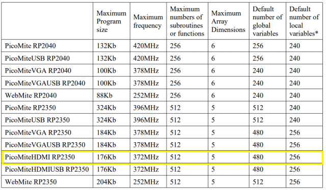

I've run into a snag: Too many local variables
  Quote  [LIBRARY] Local INTEGER k, seekPos, linkID
Error : Too many local variables
> ?MM.INFO(MAX VARS)
736

From the manual:
I know it's a big ask, but with the memory resources available with the RP2350, and chance for a further increase in the number of local variables?

You can trade globals for locals using OPTION LOCAL VARIABLES
Posted: 03:53pm
19 Mar 2026
OPTION LOCAL VARIABLES 500
Perfect. Thank you.
