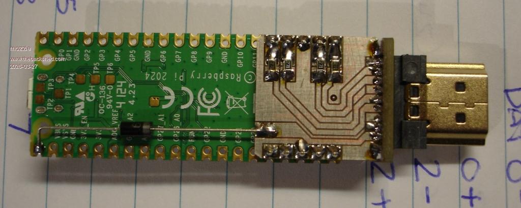

I have seen Stick PCs with a male HDMI that plugs directly in to the monitor. Anyone seen something that already exists with a Pico? My application is a standalone display. |

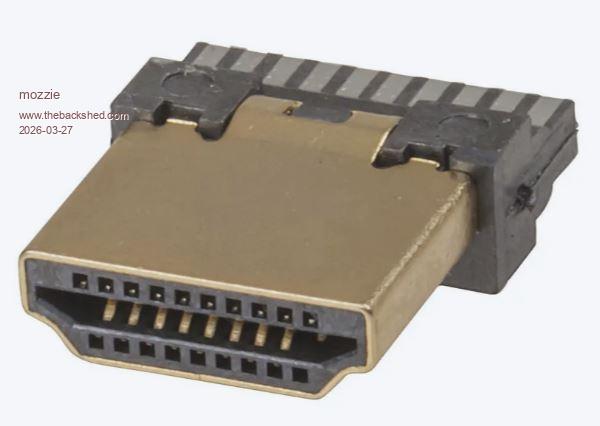

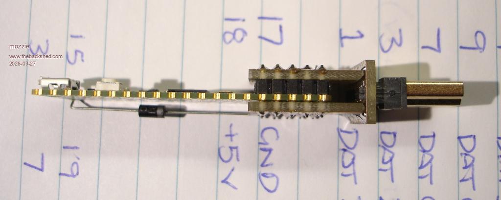

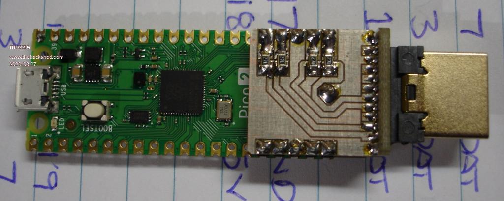

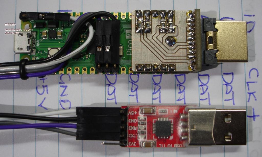

G'day, This was knocked together during early testing with HDMI, rather crude but it does the trick. Plugs straight into just about anything, the HDMI plug breakout is widely available. Apologies for the crap photo, cropped from an old image. Regards, Lyle. |
