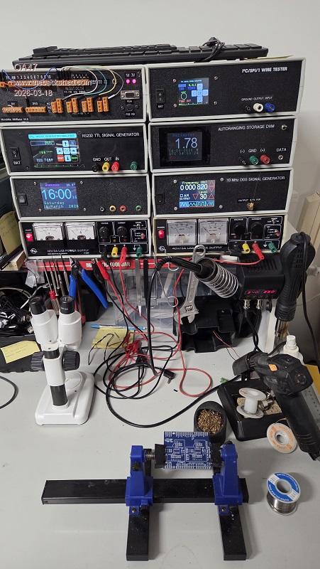

I have a project that uses a Pi Pico to generate a TTL RS232 SIGNAL STREAM and has proven very handy over time. I wanted to incorporate a signal sniffer to identify the rate and bit length of a signal under test. I have used a sample and test procedure that will go through each data rate from 150 to 921600, 7 or 8 bits and 0-2 stop bits. The software tests for a string of ascii characters and when a match is found it reports that rate and bit length. The issue is that it takes an enormous time to accomplish if the sample is at the end of the sweep.
To improve efficiency and accuracy I have thought about measuring the average frequency of the bit stream and honing in on the bit formation of the stream. Rather than rely on AI, I thought BSI may be much more helpful so I was wondering if there could be some input in structuring a routine to accomplish the task.

G'day OA47,
That's a nice looking unit you have there, along with all the rest
Are you starting with a known serial string or is it random data?

Thankyou for your replies.
  Quote  That's a nice looking unit you have there, along with all the rest
This is the home grown test gear I have put together over the years. Some Pi Pico, some Micromites, some Armmites and all get a bit of software updates as time goes on.
