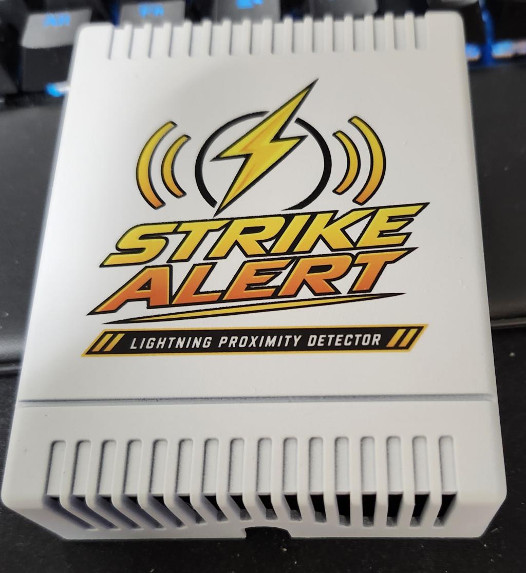

The enclosure costs about £1.47 from AE. No screws, just clips together.

I'm guessing that the cases were intended for something like an active antenna. The outer finish is far nicer than I'd expect for something like a thermostat and the cable entry position is nicely rounded (I tried but I couldn't make use of it!).

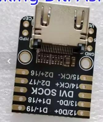

Posted: 02:55pm
12 Jul 2026
  Mixtel90 said  I don't know if anyone can use a module that allows a VGA monitor to be connected to the HSTX pins as laid out for the Adafruit DVI breakout
How about the HSTX pins as laid out for the DVI sock?
Might that be useful? (Not specifically for this project, of course.)
