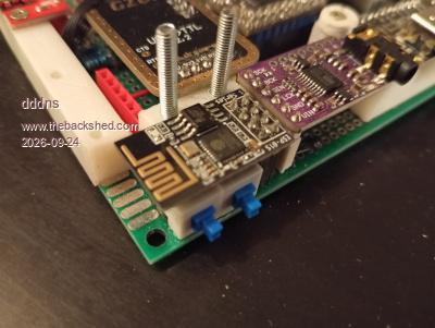

If you need maximum WiFi range perhaps that module could be put next to the HDMI socket with the antenna at (or beyond) the edge of the board. The RTC module would then need to be rotated 90° |
Hello Phil, I would like your suggested placement better as well. I looked at it for an hour but I can't find routes then and would need to add via's but there no place for them. The routes of Wifi GP23,24,25,29 cross RTC GP20,21,27,32 and to break out the inner pins of the PGA there is no more free gap either.. I will now need to rework the footprints and routing precisely and post the updated project files. Regards Edited 2026-07-31 17:02 by dddns |
Any copper at all under the wi-fi antenna will reduce the range. I don't think you have a lot of choice here, although if it is raised from the board on its connectors and you remove top and bottom copper areas immediately below the antenna it may work. It would be similar to a Pico W in free air then. I don't understand your comments about VBUS. It's a 5V supply, not 3V3, and doesn't need a regulator. Have they really restricted the VBUS output on that module rather than just using a fuse? The CP2102 module simply has a 500mA fuse (which I've never tested - I assume it self resets!}. . Edited 2026-07-31 18:14 by Mixtel90 |
Thanks for your comment Mick! I plan to solder all modules with pin headers and the board with sockets. So the RM2 will sit about 10mm above any copper. But I moved the traces underneath out of the way. All modules need 3V3. The PGA's regulator is too weak, the whole thing crashes if you only connect a SDcard to its 3V3 output. The regulator on the CH340 module is not better in terms of max current. The dedicated AMS module has the advantage to be a common solution for VBUS supply. Anyway, to adapt an USB UART module is a challenge if you would want to have a common solution that can be tinkered by everyone. That's why I'm providing the source files if one would like to modify it in some way. Sure your CP2102 could fit as well. Regards |

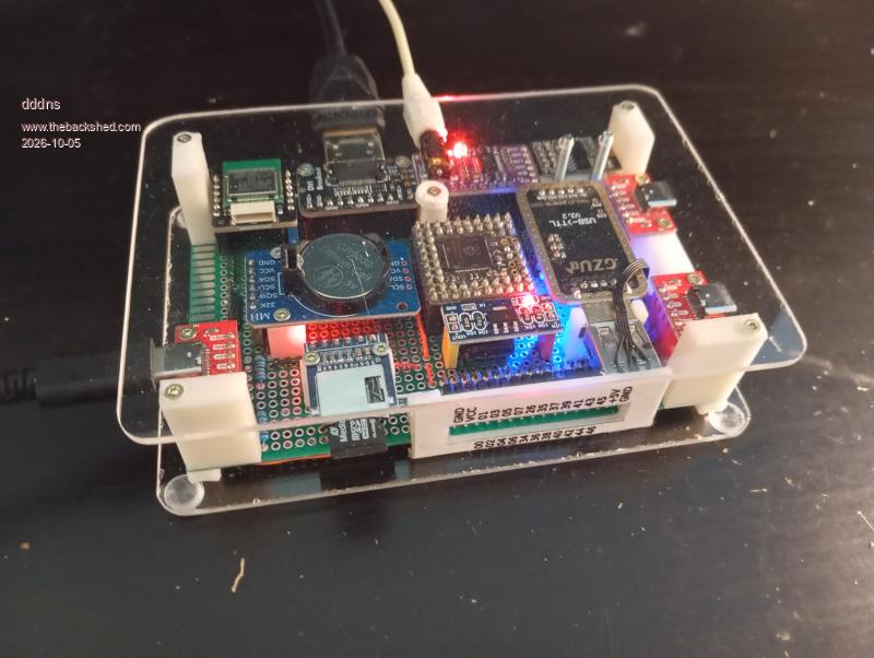

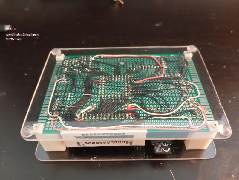

Nice Sunday! I printed some spacer and placed the parts like in KiCad. Problem is, that my perforated board has 2 rows too few in both directions. I compensated that for this prototype but will leave the design as it was but it is polished. All the mechanical parts are now done and I want to wire it with 30AWG wrap wire: ![]() ![]() ![]() ![]() PC3_THT_mini.zip |
Why not swap the wifi module and the clock module. That way the wifi can overhang the board. |

Thank you very much for your comment. Phil has already addressed the issue with Wi-Fi range. I always listen to feedback and have already tried this out. However, that would require at least a few additional via's, and I really want to keep the board single-sided. I’ll take another closer look at this! I’d like to print another enclosure and have the jacks flush with the surface. A protruding antenna wouldn’t look very good, so I have the following idea: We could use the jack that Pimoroni uses and simply attach the module mechanically to the cover, then connect it to the board via the cable before closing the enclosure. I think that could be a pretty elegant solution!? Update: The Wi-Fi module's antenna is now positioned at the very edge. The routing looks good this way, too. ![]() PC3_THT_miniV1.zip Edited 2026-08-03 17:35 by dddns |
