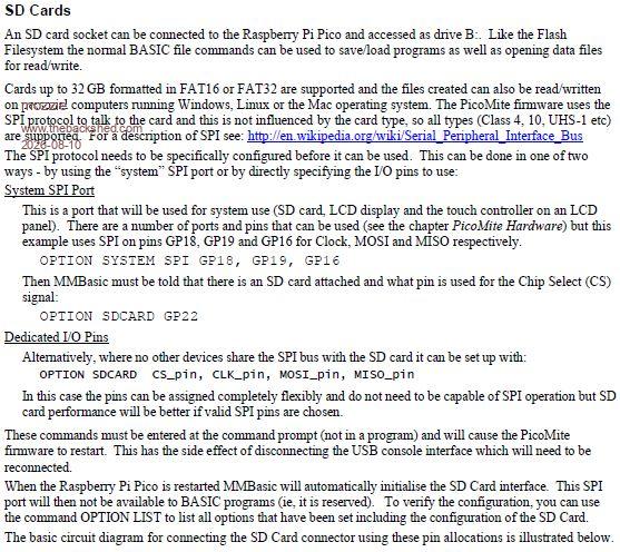

I think this has been mentioned in the past and the verdict was OPTION SYSTEM SPI is only available on LCD versions. However with HDMI + resistive touch screens now in use it could be useful for sharing with the SD card. Edited 2026-08-10 10:57 by phil99 |
G'day, Phil, you hit the nail on the head looking back through all the saved option lists for HDMIUSB versions and non are showing OPTION SYSTEM SPI, my head says otherwise but in the light of a new day I am mistaken. Sadly we cannot have SPI touch with HDMI so SYSTEM SPI is not really relevant.Also thanks for the Ascii table, very easy to use Peter, my apologies, another red herring Perhaps a note in a future version of the manual would be useful to avoid confusion. Regards, Lyle. |
