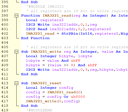

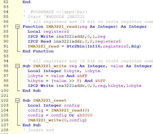

Gerry, This used the source before your change to INCLUDE paths. I have added code in 4 places. You should be able to find it by searching for tassyjim (in comments) So far, I have only returned the expanded file to MMEdit. Changes: before start of processing - globals and extractmodule procedure just after "wrong num parameters" - read preferences before debug directive - codebase and codemodule directives start of Production output - close files and write preferences On first run, a file "MMmodule.inf is created in the MMEdit5 data folder The only entry is for the path to the module source files. They can be in a sub-folder. If blank, the absolute path is required for the source files, To change this base folder, use #CODEBASE folder$ in your .bas file to insert a module, use #CODEMODULE modulefilename$ name$ module filename can include a path relative to the codebase folder no spaces in path In the library/module files, start the module with '#MODULE name$ no quotes and no spaces conclude the module with '#MODULEEND Permitted: any number of modules in any number of files. File to receive module ![]() After running "replace" ![]() Module fie: ![]() Source and exe MMReplaceV5All.zip No alterations to any other code so I don't think I have messed with the running Jim |
