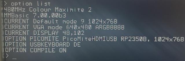

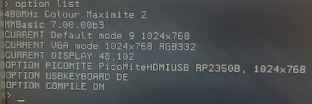

I am confused about screen resolutions, modes and so on. I think I do not understand the system.
I use my cmm2 on a vga monitor with resolution 1024,768.
so I entered "option default mode 9" because I want to "use" the pixels 1:1.
I also entered "option picomite hdmi, 1024x768.
option list:
When I now start a program without any command like resolution, mode etc...
(1 liner : Print "Hello")
the computer switches to 640x480. and it stays so in the command line.
the "current vga" changed to 640x480
if I enter now "edit" the editor opens in 1024x768 and it stays so after esc.
is "option default mode 9" incompatible with "option picomite"?
Edited 2026-10-26 19:59 by hhtg1968
