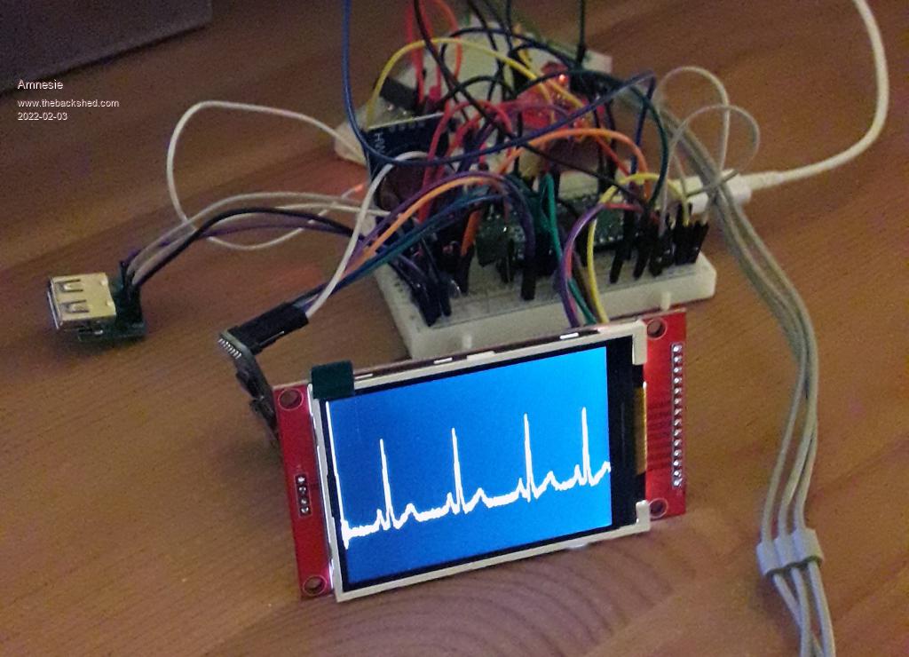

...well kind of! Short story: After building the Colour Maximite 2, the PicoMite has waaay more potenital in my opinion, because you can source all the parts for cheap in every country.
I often felt my heart does some extra beats (premature ventricular contractions)I thought I can visualize those and build an ECG. I did this in the past with an Arduino, but now is the time to put the picoMite to the test! It is really amazing how simple
you can get a primitive ECG programmed in BASIC.
No extra beats on this image :) And ignore the messy work, I already designed a PCB which is on its way from JLC.
This is my code so far:

Yes it is way from perfect, in fact this was just a quick test.
I set it up with interrupts for later digital filters (notch filter to get rid of movements and 50hz noise). Also I plan to write the data to the SD card to analyze it with proper ECG software. I just want to thank all people involved in this great conversion to the RaspberryPi Pico! As soon as I implemented digital filters I post my progress.
Greetings and keep up this great work and forum!

Hi Daniel,
A great project!
I bet there will be a lot of interest on here.
What have you done for sensors - I guess that they are the grey cables bottom right of the picture?

Amnesie
Yes, it is the well known AD8232 sensor for just 3 euro in Germany, which really works great. I am sure it is possible to build a lot of features in this BASIC program. At first I will concentrate on filtering noise, but this should be no problem since there is enough cpu power, it even works on an arduino I just have to port it from C to BASIC language. I am a little bit new to this, so it will be fun as well :)
Also planned is SD card output and audio warnings, glad that Peter fixed the wav audio skipping bug in the firmware.

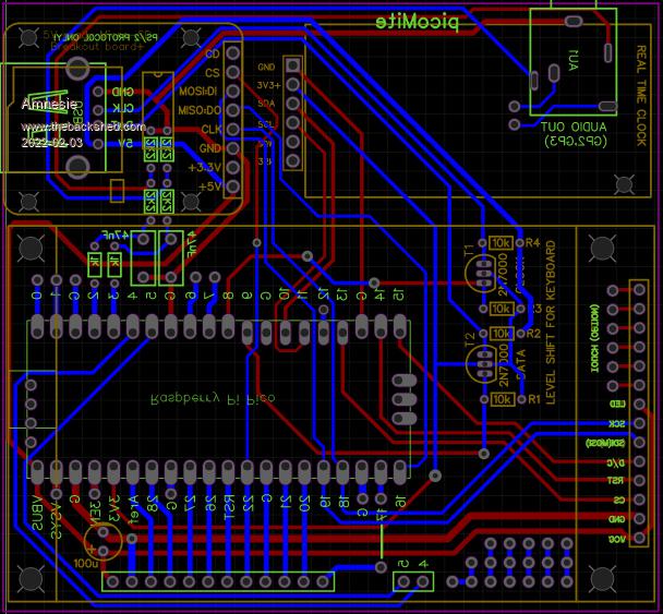

Posted: 11:24pm
02 Feb 2022
Amnesie
@ Jim,
wow this is interesting, and I hope it is nothing serious! I was a bit nervous because of my extra beats, so my first Arduino version of this ECG was born, with this I discovered the extra beats myself, so I went to a doctor and he just laughed about my little device. But now I have some fun with the picoMite which has way more power... :)
This is my designed PCB for general purpose projects for the picoMite.. if everythings works I can upload the gerbers if there is interest.
Some features like RTC, KEYBOARD, LCD, SDCARD etc.. are on board. I am not using the onboard SD socket of the display because it is bad quality... The Adafruit breakouts are way better.

Posted: 02:54pm
03 Feb 2022
Neat indeed. Please do post the gerbers (or wait if you think you have further refinements). And please post a link to your sensors. Which PCB design software did you use?
Maybe run MISO with an inline 680R resistor so that a larger SPI 480x320 ILI9488 may be used (although it could be used with MISO not connected as long as BLIT READ or similar isn't wanted--or, perhaps more importantly for this application, SAVE IMAGE).
Edited 2022-02-04 00:56 by lizby
Posted: 06:40pm
03 Feb 2022
Amnesie
Thank you lizby for your advice! I am using easyEDA as "software".

Posted: 06:28am
04 Feb 2022
Hi Amnesie,
The heartheat is a small signal that could be drowned in mains hum. By using 100hz sample rate you are almost eliminating the hum, since it is almost synchronous with 50hz mains in Germany.
Why not completely eliminate the by sampling at each zero crossing of the mains voltage? That would give a minor fault in heartbeat(0.1% max mains frequency drift) but translate all hum to dc(offset). So only remaining is a simple high pass filter for body movement.
P.S. also ordered a ECG kit, and few new pico's (I ran out of them) since I got interested. Thanks for posting...
P.P.S. did you look at the MATH commands, it these could be used to do the filtering faster ?

Posted: 09:57am
04 Feb 2022
Amnesie
Thank you all for advice! Since I am completly new to BASIC this is much appreciated. I will follow your suggestions and keep the ISR as short as possible and check the MATH commands.
I encountered already a problem due to this (I think): I tried within the interrupt routine to write the ECG data (100Hz sample rate) to the SD-Card with really bad results, the graph is slower and way more noise is introduced, I think this is the wrong approach anyway (maybe buffering data and then send it to the sd card?). Jim mentioned I could even do a image once I press a button, for example with the SAVE IMAGE "test" command, but always the picture taken is completly white. I tested the command even directly in the prompt, always the same. The whole bmp image is white. But with the ILI9341 TFT I am using it should work?!
@ Volhout the idea with the 50hz filtering is good, but in my special case the hum isn't exactly at 50Hz... With this filter constants I've got almost no noise. But of course there are more filter to add anyway (50Hz, 40Hz low pass, 1Hz high pass etc)
Thank you all!
