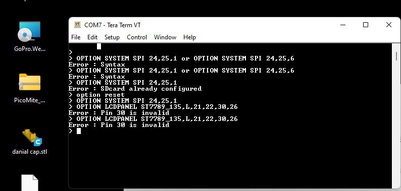

Hi matherp thank you for the quick response, I jumped up and tried it and got an error that pin 30 was invalid :( Also could I be a Pain and beg for some sample code that would print 2 variables on 2 lines PLEASE

Their docs show LCD_RESET connected to 30
Perhaps they are resetting with the RUN pin?
Try
OPTION LCDPANEL ST7789_135,L,21,31,22,26
TEXT 0,0,"line1"
TEXT 0,mm.fontheight,"line2"

OPTION SYSTEM SPI 24,25,1
is the TICKET

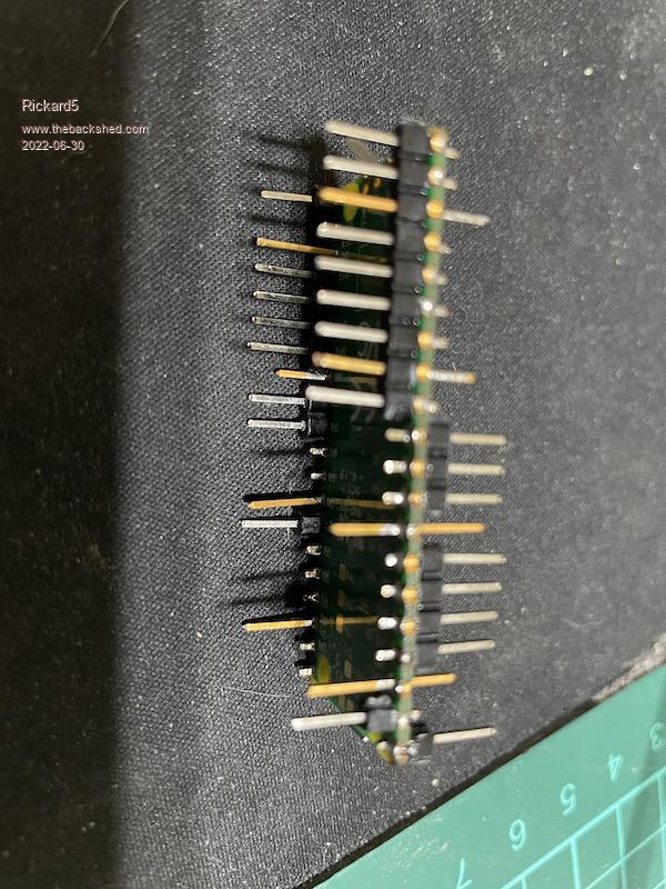

HI P my low buck solution I only put in the required pins down and thew "Other Pins" up to access "all the other Pins" Right now I use old Bread Boards as Fixtures to Solder pins in until my Phenolic material  gets here then I'm gonna make some Solder Jigs on the HAAS CNC machining center.
