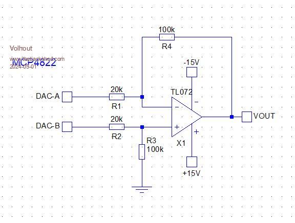

Best is to use the DUAL DAC (both channels) to generate a single +/-10V output.
Really? Don't believe I ever came across this but it sounds cool
Do you have a schematic?

Something like this:
This circuit should translate 2V output of the DAC to +/- 10V.
It outputs the difference between A and B. So write 4095 to A and 0 to B and you have -10V. St both to 0, or 4096, or 1999, and the output is 0. A=0 and B=4095 is +10V.
Easiest is A = 4095-B
Resistors must be 1% or better.

So instead of 20V/4096, I now get 20V/8192 (13bit effectively)?
Posted: 09:51am
01 May 2024
EDIT:
Yes essentially you could get 13 bits.
But not with A=4095-B
Edited 2024-05-01 19:58 by Volhout
