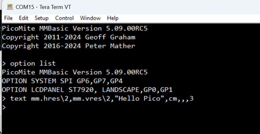

Posted: 01:47pm
25 Jul 2024
This version is tested and working. I think the garbage was because I was clocking the SPI bus too fast.
PicoMite.zip
Connections as tested
GND - 1,15,20
5V - 2,19
GP0 - 4 (RS)
GP1 - 17 (RST)
GP6 - 6 (E)
GP7 - 5 (R/W)

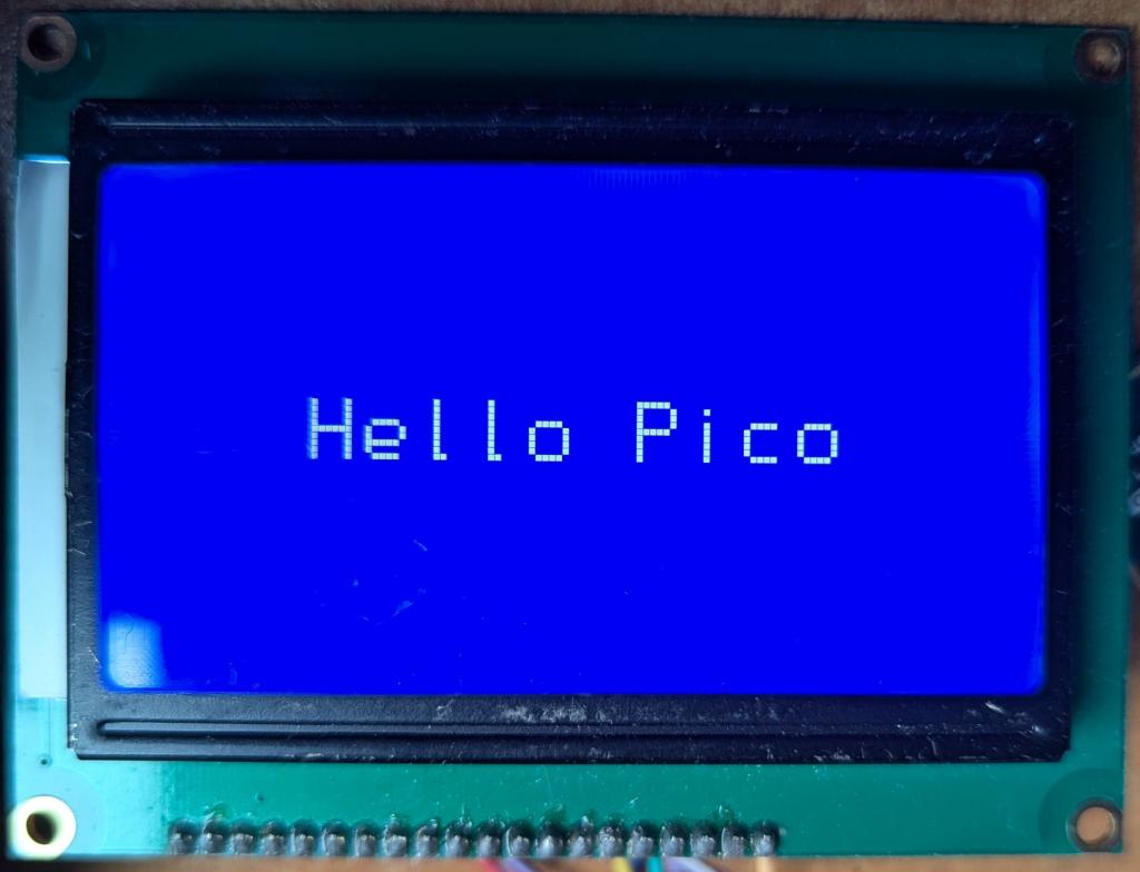

Posted: 05:39am
27 Jul 2024
58kk90
I can confirm that it works perfectly using the Chinese Ebay ST7920 LCD's
Tried both the white backlit version and the yellow backlit version, the yellow was the 3.3v version and the white was the 5v version, both work perfectly with the Pico.
Thanks Peter.
Tony
