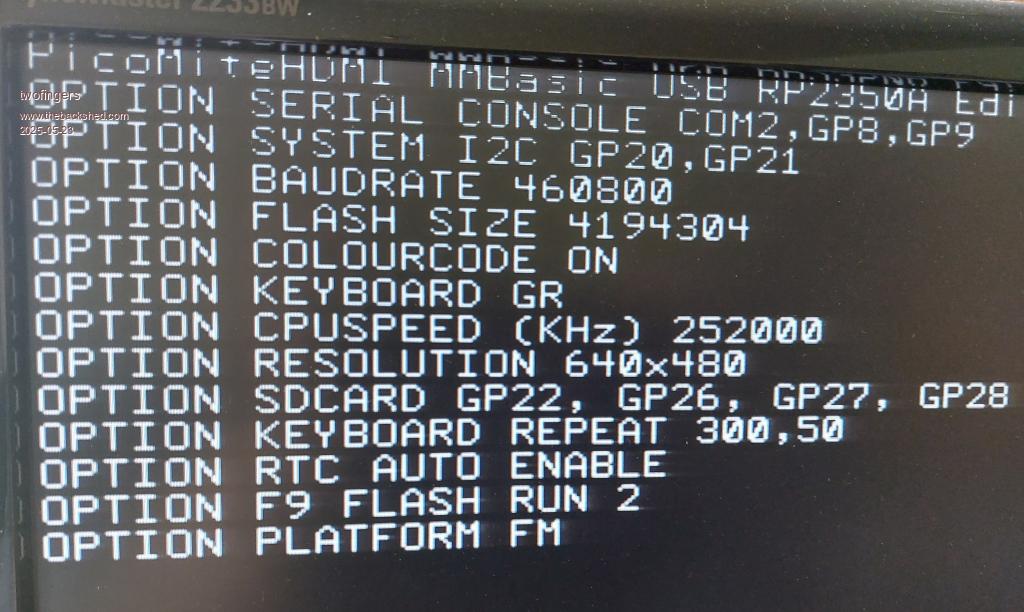

Maybe the manual shows something wrong, at least for Mode 1? Michael
