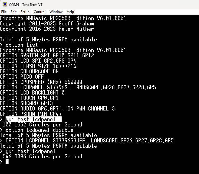

High speed buffered display drivers
The new release supports the following new display drivers
ILI9341BUFF: 320 x 240
ST7796SPBUFF: 320 x 320
ST7796SBUFF: 480 x 320
ILI9488PBUFF: 320 x 320
ILI9488BUFF: 480 x 320
ILI9488WBUFF: 480 x 320 'Waveshare Pico-Restouch-lcd-3.5
ST7789_320BUFF: 320 x 240 'Waveshare Pico-Restouch-lcd-2.8
In all cases enabling one of these drivers steals a RGB332 framebuffer from the heap so in the worst case of a ILI9488BUFF heap is reduced by 150K bytes (from 300K)
To use one of these drivers you first need to allocate the SPI pins to be used
OPTION LCD PINS clkpin, mosipin, misopin
These pins are dedicated to the display and must be separate from any pins used for the SYSTEM SPI which may still be required for touch and the sdcard (NB: in the case of the Waveshare boards using this driver will conflict with also using touch and the sdcard as they share the SPI channel)
The reason for the dedicated pins is that the screen updates will all take place on the second processor and for maximum performance this cannot share the SPI channel.
How much faster are these drivers? I've included in GUI TEST LCDPANEL an output when you exit the test that reports the number of circles drawn per second.
MUCH FASTER!!!
AFAIK all normal graphics work using the new drivers and they are tested with Petscii and work properly. Using these drivers, the use of the ILI9488 and particularly the ST7796S displays work very well as console devices. For maximum performance with the ST7796S display a CPU speed of 360MHz is recommended. This allows the SPI channel to the display to run at 90MHz giving a full screen refresh time of about 14mSec with no load on the main processor.
Of course the downside is that the screen is only using 256 colours instead of the full 65536. A later beta will include a MAP capability so that you can select the 256 colours to be used out of the full RGB888 palette.

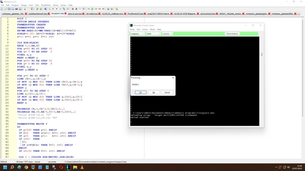

Posted: 09:52pm
23 Jul 2025
what's this new box and how to bypass it when flashing prog? please
Posted: 10:09pm
23 Jul 2025
Stan,
Your problem is nothing to do with the new MMBasic betas.
You have selected "command" as the device instead of picomite

Hi Peter,
I've reproduced your circles test pattern and tuned it to give me about 100 cps, the same as your demo, with the CPU at 360MHz and standard LCD drivers, using a ST7796S LCD panel.
I then changed to the ST7796SBUFF driver, I do get a doubling in speed, to about 200 cps, which is not bad, but not as good as your 500 cps, though I do get the same results as you using the GUI TEST LCDPANEL about 540 cps.
I've tried enabeling and disabeling the AUTOREFRESH, both within the code and at the command prompt, nothing I do makes the slightest difference, though the command is accepted, no errors?
I've tried Option autorefresh on/off, both in and out of a program, the LCD still updates exactly the same and still draws about 200 cps.
What am I doing wrong? please help. :-)

I'm using GUI TEST LCDPANEL not a Basic program. Will post a full set of firmware later.
