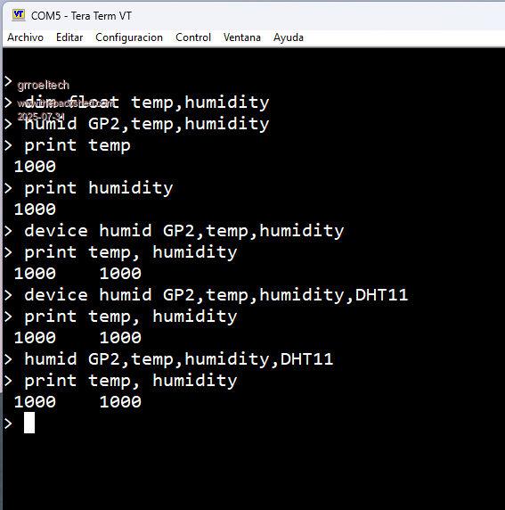

I updated a Pico 2W with the latest version of WebMite. Now, when I run the HUMID command (DEVICE HUMID GP28 temp, humidity, DHT11), it returns 1000 and 1000 for temperature and humidity. The connections and pin assignments are the same as before. Just in case the DHT11 was broken, I tried other units, and the error persists. With the previous version of WebMite, it gave correct values. Any clues?

The manual currently says HUMID pin, tvar, hvar [,DHT11]
But in the past it was HUMID pin, tvar, hvar [,1]
So for the DHT11 it was HUMID pin, tvar, hvar, 1 so that may be worth a try.
Edit.
Yes that works, so the new manual has a typo.
> HUMID gp2,tvar,hvar,1 :? tvar,hvar
10.1    88
Edited 2025-07-31 21:25 by phil99

None of the ways work.

Eureka !!,
BITBANG HUMID GP2, temp, humidity, 1
works !! The key is the value “1” instead of DHT11. Also work with DEVICE or HUMID alone.

You cant use "temp" as variable, its a reserved command.
Dim mytemp!, myhumid!
BITBANG HUMID GP2, mtemp!, myhumid!, 1
Print mytemp!, myhumid!
Try that?

From the current manual (I just wanted to be sure it was correct)
  Quote  The optional DHT11 parameter modifies the timings to work with the DHT11.
Set to 1 for DHT11 and 0 or omit for DHT22.
DHT11 is treated as a variable set to zero. Use OPTION EXPLICIT and this sort of problem will never occur!

Sorry for my mistake, I didn't realize that DHT11 is a value, 0 or 1, and not a parameter.
I'm careless.
