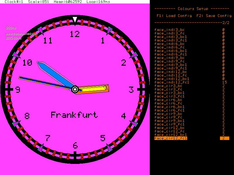

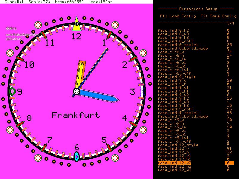

Hello :) I have written an UI to build an analog clock with various elements. All the parameters can be setup with this, at the moment there are 5 designs which can be altered as you like. There are 3 sections for dimensions, colours and the clock hands. Every section can be saved to disk or the whole object as a snapshot. Once you are finished it can be exported as a running basic program with an empty main loop, or only the DIM statements can be generated. It runs on a 2350 in any resolution for MODE 1 and 2 and it runs in any MODE with resolution 1024 and above. The program is too big and cannot be loaded from disk in Resolution 800 or 848. Please test it and leave a comment what you think. ![]() ![]() VGAcD.zip |

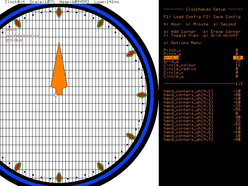

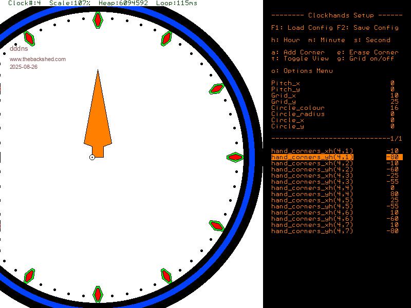

Hello :) I have written the routines for: - adding a corner to a hand. Corner is inserted below the cursor position and is a copy of it. A pitch can be set which will be added to the new coordinate so you can set them in a row. - deleting a corner - visualizing the corner of the current cursor position with a marker - displaying a grid All other routines are reworked and error handling is done. The extracted dim's need to have the drawing library which needs to be installed first and is included in the zip. VGAcD.zip ![]() ![]() |

Hello :) I have added the last features I wanted and wrote the routines. That's why I have rewrote and sorted have of it. But that makes a nice difference and gain in speed. An average design takes about 100ms and even in MODE 3 800x600 it never exceeds 200ms even if overloaded with items. 3,6,9 and 12 can be individual now. All polygons have a build mode and can be triangle, box, 8corner or 14 corner. Also it can be a circle with alignment or a combination. This shows all possibilities, don't laugh :) ![]() - all menus have page numbers - removed all string operations in the drawing routine - shorted and renamed all variables - cursor speed increases after 2sec when changing a value Can't remember all changes but I think it runs pretty ok now. I think some rework and it's done so far. At the moment it runs only up to Resolution 800 without PSRAM but I have an idea how to solve it. ![]() VGAcD1.zip Edited 2025-09-12 09:12 by dddns |
