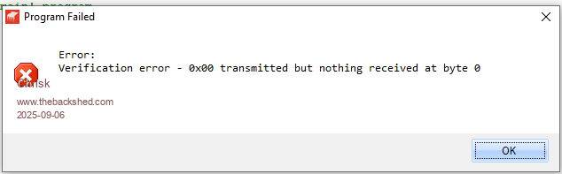

Hi Guys Well I thought using a PICAXE for a small function would be an easy way to go. Wrong! I have a temporary setup to load the program but I am receiving this error. I am using Picaxe Editor 6 to program the Picaxe. The program has no problem when I use the simulator but upon loading I get this error. I don't know if it is the cable or the driver. I have attempted to load a couple of drivers but Windows always seems to say this is the correct driver. Any ideas? Chrisk ![]() |

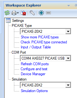

Refresh the com ports, and select from the pick list, the port with AXE027 USB Driver. ![]() Mike |
Tried doing the refresh and using Com Port 10 Windows refuses to use the PICAXE driver. Keeps telling me that the correct driver is installed. I had this trouble before with another project and driver and I don't remember how I overcame it. Thanks for the quick replies. HAPPY FATHERS DAY to all you fathers. Chris K |

Connect your 20X2 chip(or whatever chip), then click on the blue line below the PICAXE type drop-down box, that says: "Check PICAXE type connected" You should get a response and confirmation from PE. That's quite possibly your problem right there. For USB programming of PICAXE chips, you really should ONLY use the RevEd USB programming cable. More expensive then the cheap Chinese copy, yes, but there is a reason the copy is so cheap. Get a genuine AXE027 cable, and I bet your problems will vanish. I wouldn't mind betting, your problem is the cheap copy cable, in other words. |

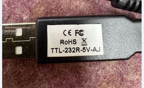

Hi Guys Here is the USB end of the AXE027 Chinese cable the other end is the standard 3.5mm audio connector. The label does state 5V TTL. Chrisk |

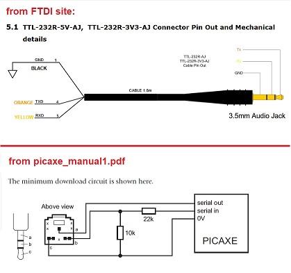

I checked the code TTL-232R-5V-AJ and it's a standard FTDI usb to TTL cable sold by a lot of companies. The FTDI datasheet shows the 3.5mm plug as tip is Tx ring is Rx and sleeve is GND (0v) But the AXE027 is wired differently: tip is 0V ring is Tx sleeve is Rx ![]() Maybe that's the issue. regards Peter |
...and remember that the protocol needs to be INVERTED as mentioned by circuit I'm convinced the cable is your problem. So far, we have established that: 1) It's a cheap Chinese copy and not the genuine cable 2) It's 3.5mm plug is wired differently to the genuine cable 3) It's standard TTL and the PICAXE is looking for INVERTED TTL. Any one of those three would cause an issue, but you have ALL three working against you here. Bin it - it is completely false advertising to say this thing is an AXE027 cable, cos it's very clearly NOT. But then, false advertising is how all this stuff gets sold. Look at the 2TB USB flash-drives you can buy for about fifty bucks! ![]() Edited 2025-09-10 10:32 by Grogster |
The FTDI wiring is standard. PICAXE have used nonstandard wiring so you need to buy their overpriced unit. If the signal is standard TTL serial the polarity of the data needs to be inverted, as mentioned by Volhout. TTL serial is idle high, data low but the PICAXE requires idle low, data high. To check this plug it into a USB port and measure between sleeve (0V in FTDI diagram) and the tip (Tx in FTDI diagram). If you get near 0V you just need to rewire the plug by chopping the lead and reconnecting the wires. If you get 5V you will also need a pair of logic inverters. NAND or NOR gates will also work if the inputs are connected together. A pair of transistors will also do the job. Edit Ripped off! I got one with a USB-C cable and A to C adapter for $20. After getting a refund pulled it apart and found a 16GB thumb drive plugged into an adapter. So now have those bits for free. Edited 2025-09-10 10:47 by phil99 |

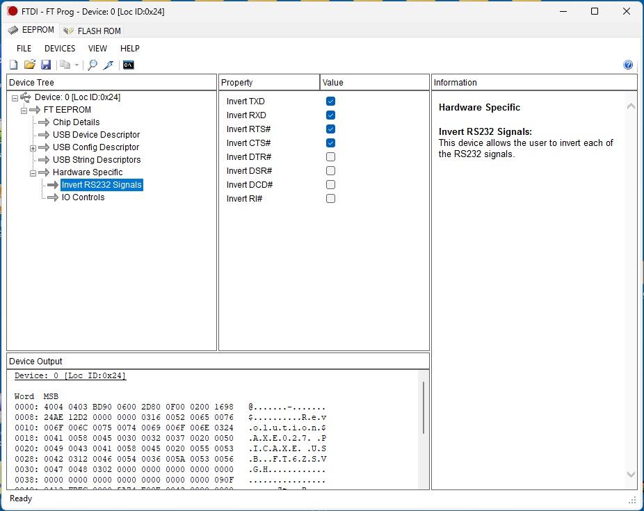

If it's using a proper FT232R IC inside the USB plug then there is a way to invert the Tx,Rx logic. FTDI have a utility called FT_PROG which allows anyone to reprogram the IC's internal EEPROM. One of the parameters sets the logic of the signals. I've used the FT232R a lot but the only time I needed to invert the signal logic is when using it with a PICAXE. I haven't looked deeply into it but I don't think the CP21xx or Prolific USB-to-TTL ICs have this option. This is why Revolution Education use the FTDI IC. Here's a screenshot of the setting using a genuine AXE027 & FT_PROG ![]() Forgot to mention, if you do change any settings in the FT232R make sure you unplug and then plug the USB cable back in so it loads the new settings. Edited 2025-09-10 11:46 by ElectroPI |
