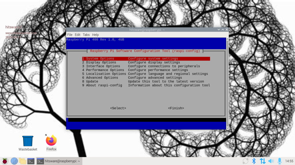

I had a rpi 400 using twister os and the keyboard seemed faulty, ie different keys the same. reported by others when I searched.
anyway I dug it out over the weekend and installed bookworm 64bit os and the keyboard works ok. Youtube playback is much better, over wifi. Just got to learn Linux

Depending on what you want to do ,
not that much Linux needed .
I would also try :
32bit vs 64bit Bookworm
Bullseye OS
Fyde OS
Different browsers ( Chromium , Firefox , Falkon , et . al . )
The beauty of the RPi is the ease of tweeking .

not easy now to edit config.txt.
have rpi 1,2,3,400.
this didn't work / fill screen .no hdmi sound on first tv but fine on another.
impressed with youtube play back over wi-fi. no dropped frames. vlc video playback from usb fine. big difference to twister os

hitsware2
sudo raspi-config

hitsware2
Pi os does seem to work best overall .
The latest uses Wayland ( ?? ) which messes up some
of my use .... ( So I use Bullseye for those  )
With os ' s on thumb drives it ' s an easy switch .

sudo nano config.txt is now config.sys. not like bullseye

hitsware2
  stanleyella said
  hitsware2 said
sudo raspi-config
This won't do what you want ?

I always used sudo raspi-config from when I first discovered it. It's definitely the easiest way to set things up. :)  I'm a nano fan too, but only when it's needed. :)
