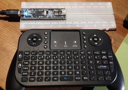

a few more tests I did on the mini keyboard ![]() ![]() ![]() I can't get the trackpad to work, nor the mouse buttons. /Peter63 |

![]() I tested the mini keyboard again. Wanted to see if the trackpad worked, and sure enough it worked. Used the same program that I used when I tested the mouse. /Peter63 |

Tested version: PicoMiteBTH MMBasic RP2350B V6.03.00RC24 Just letting you know that my little mini keyboard (BT) works on version RC24 Using-board: Pimoroni Pico LiPo 2 XLW (PIM776) > option list PicoMiteBTH MMBasic RP2350B V6.03.00RC24 OPTION FLASH SIZE 16777216 OPTION COLOURCODE ON OPTION KEYBOARD US OPTION HEARTBEAT OFF OPTION PICO OFF OPTION CPUSPEED (KHz) 200000 > Bluetooth Keyboard Connected ![]() /Peter63 |
