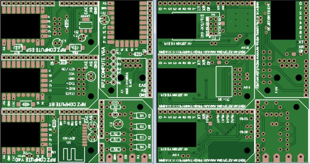

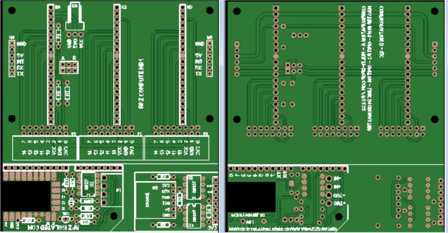

24 Jun 2026
In this vein of multiple MMBasic devices talking to each other there's also Mick's RPZ Compute model, though I've not seen that it was built out by anyone but me, and I didn't do anything but the most elementary testing.
But it's not a whole project, case, screen, printer, keyboard device with working software.
Edited 2026-06-24 20:45 by lizby
Posted: 10:56am
24 Jun 2026
I'd almost forgotten that. :) I didn't build it either. It used multi-drop RS-232, which seems to be fine over short distances. More like I2C but with TX and RX buffers as it uses the COM ports.
I got a lot of fun out of designing it. :)
