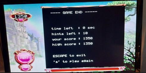

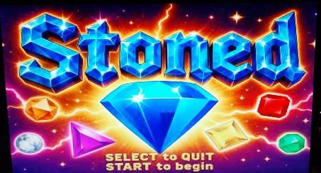

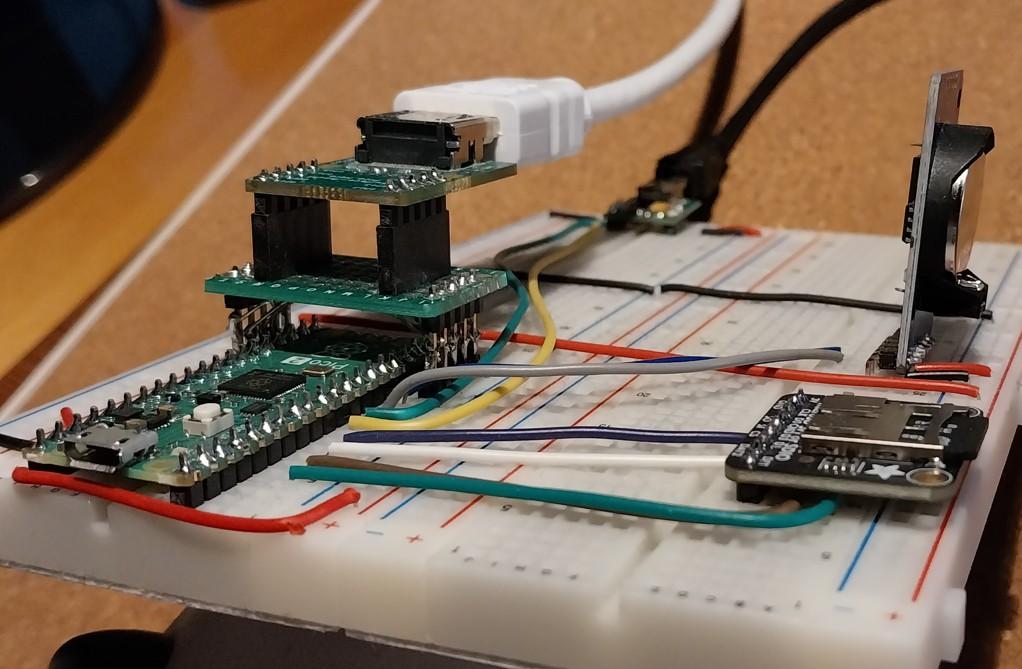

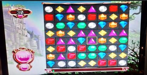

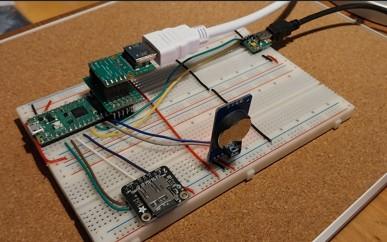

Peter63
Hello,
Did a quick test, Pico2 HDMI seems to work just fine.
A bit of older firmware installed V6.03.00RC11
PicoMiteHDMI MMBasic USB RP2350A Edition V6.03.00RC11
OPTION SYSTEM I2C GP10,GP11
OPTION FLASH SIZE 4194304
OPTION COLOURCODE ON
OPTION MOUSE SENSITIVITY     1.0000
OPTION KEYBOARD US
OPTION RESOLUTION 640x480 @ 252000KHz
OPTION DISPLAY 30, 53
OPTION SDCARD GP5, GP6, GP4, GP3
OPTION RTC AUTO ENABLE
/Peter63

al18
Volhout,
Thanks - great looking game.
Peter63,
What is that device with cheese wiz on it?

Peter63
  Quote  What is that device with cheese wiz on it?
breadboard from the side
The HDMI adapter might have ended up a bit unnecessarily tall when I built it.
/Peter63
