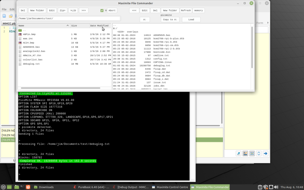

Hi Jim,
Tested on Ubuntu 20.04 this MMCC file manager works fine on 2040 and 2350.
Speeds on 2350 (mp3 file) was between 60 and 20 kB, on 2040 between 60 and 14 kB per second.
I tested large files, and multiple small files in batch copies back and forth.
Later today I will test the combination with MMEdit 542 (test if the complete IDE works).
P.S. there is one issue (that you may not be able to fix since it is probably in MMBasic): when a filename is legal in linux, but contains a comma "," it transfers correct from PC to pico. But the transfer back does not work. It starts erroring with a "short block" error message. When I change the file name on the pico to "test.mp3" the file transfers fine (back and forth). Again, this is something I noticed, and may not be worth fixing. Who in gods name would use a comma in a filename..???
Edited 2026-08-06 20:47 by Volhout

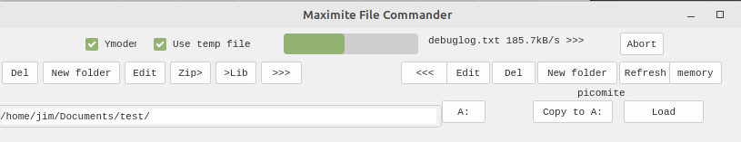

08 Aug 2026
Does this speed look acceptable?
This is on Linux. Windows is slightly slower.
It does depend on the file type.
Tick the new option "Use temp file" and transfers to the 'mite will go to a temporary file then, when completed, rename to the target name.
Going to the PC will always use the temp file.
Linux version:
MMCC.zip
Windows version:
MMCC_windows.zip

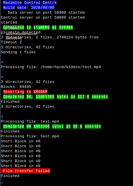

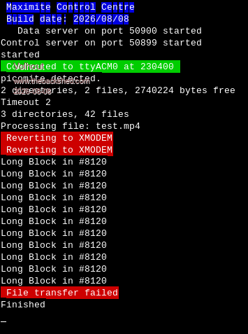

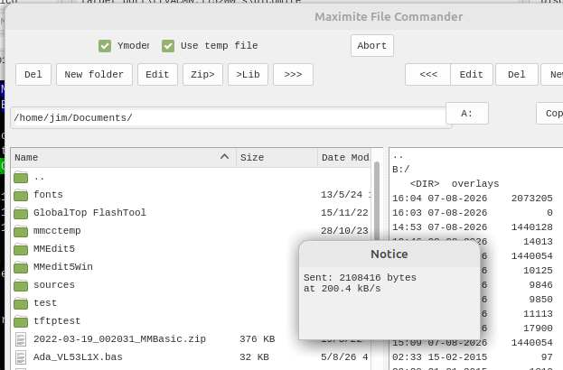

Tested the new MMCC and there are 2 remarks on Ubuntu 20.04.
1/ The speed I achieve (on RP2040 GEEK running 200MHz) is 52kbps towards the pico. But that is back to "normal" since that is also roughly what 535/537 achieves.
2/ One problem is that uploading back to the PC, there is in many cases no popup showing progress (see 4). I tried repowering GEEK, restarting MMCC, but there is no progress popup. In the end the file is transferred, but no progress.
3/ On large files, only part of the file is transferred. Exactly 10Mbyte is missing.
As you can see 11455360 bytes are transferred to B drive of pico. But trying to transfer this same file back to the PC indicates 1455360 bytes are transferred. And indeed, the file size on the PC is 1Mbyte (not 10Mbyte).
4/ maybe relates to issue 2. Above screenshot is taken on a transfer that disabled YMODEM (to force XMODEM). When you enable YMODEM, there is a double "reverting to XMODEM". The "long block" error messages are because I interrupted the transfer. They normally do not show. You simply get a message saying "finished".
So there is no progress popup on XMODEM when YMODEM is enabled, but XMODEM is selected anyway. But there is a progress popup when YMODEM is disabled.
P.S. speed from pico to PC is 25kbps.
