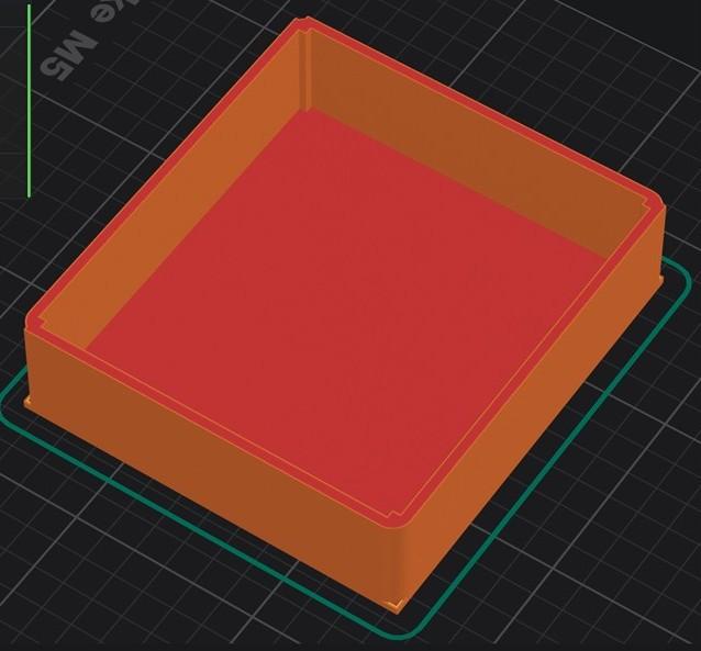

Hi Bryan, My printer uses 'eufyMake Studio' which is based on 'PrusaSlicer'. It imported your .stl with no problems. The attached image is what my machine would have printed. Notice the 'effect' on the corners: - The base is still square but above it is rounded. - There are also square intrusions into the interior. Cheers, Andrew ![]() |

ok got the box finished and yes those 2mm radius's are still there on the base as I kept forgetting to update the base. Now to get on and draw up the lid then the PICO 3 Case can be updated pico3box.zip Regards Bryan Edit: I had a look on flash forge and found a major error where the holes were imposed on the inner so got the bug fixed and looking now on flash forge it does look the goods. so updated the zip file. Edited 2026-08-14 17:02 by Bryan1 |

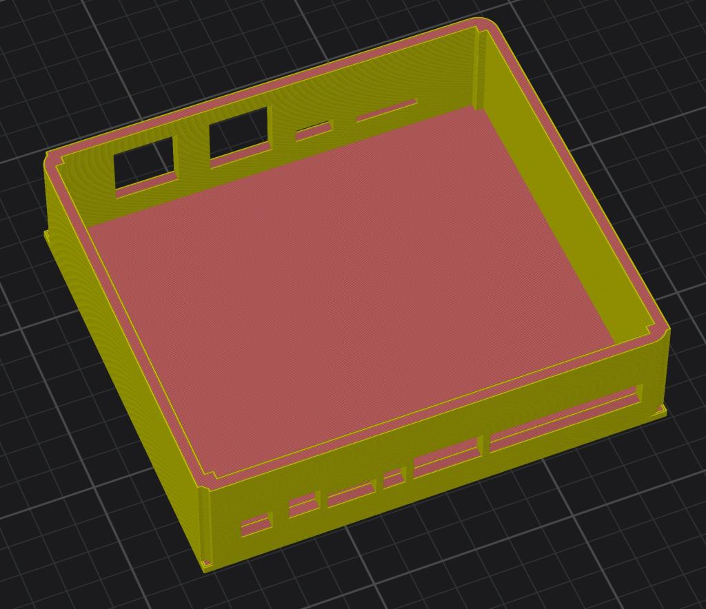

Hi Bryan, The effects are still in the corners, Andrew ![]() |
Hi Andrew yes it seems Claude had stuffed up the 'radius' function and it is quite clear as only 1 corner has the right radius also that standoff function has to go to stop those inlays in the inside corners. Now also looking at the picture I'm going back in the .model file and put the right figures in as I got the direction of the holes backwards on both sides or more than likely it was Claude when he fixed the issue with thru holes Anyway today's job is to setup 2 more boards with club.py as got the meeting next Tuesday night and check each one with the GPS where I do need to get on and design the box to hold the GPS. Regards Bryan |
