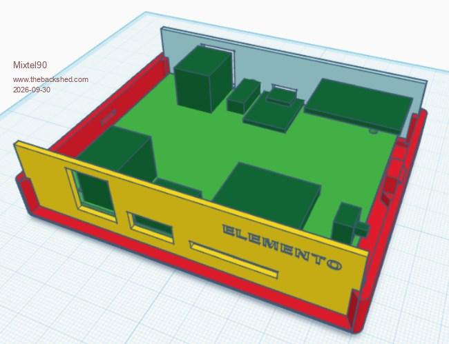

Today I've been sorting out a box for the Elemento. It looks rather nice :) ![]() I'll do one for the PC3x next. It should be easy enough to modify the panels for the PC3 though, it's the same box. The bed size is still the ruling factor on any box wider than 110mm if I print using a "raft". The big box half in the picture is 120mm wide and the poor printer was hammering the end stops of the x-axis to print a "raft" 127mm wide (the physical size of the bed). I was quite surprised that it managed it. :) When the inserts turn up I'll do a test print to see how well they work. I'll also try direct to bed printing at the same time as it doesn't matter if a test print gets mangled. If anyone wants STL files for these just shout and I'll sort them out. |

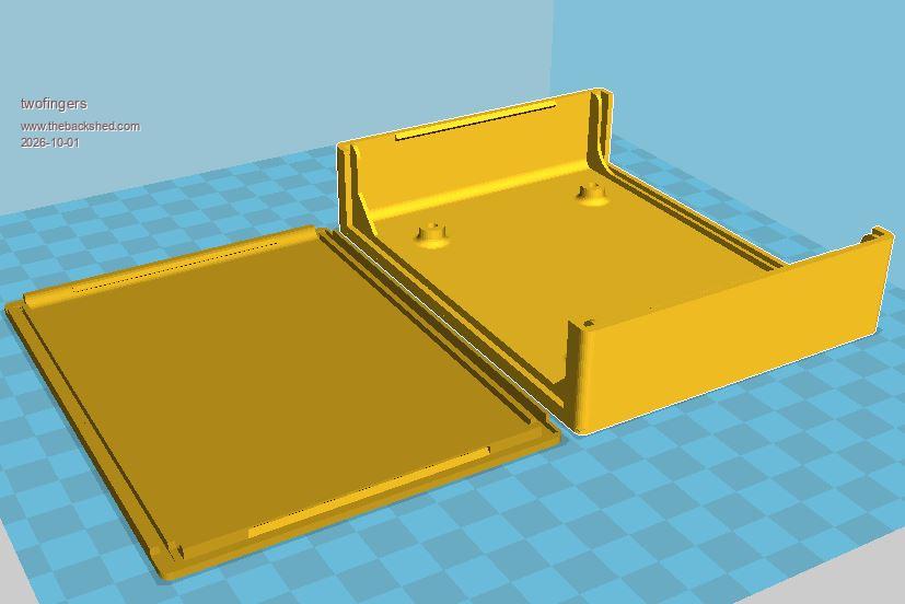

@Mick, thanks! This is my attempt to design an enclosure (in Fusion 360) featuring a screwless lid and interchangeable panels - and not just for PicoMites. However, the lid isn't very secure! PicoCase MB04.zip It is designed for use with heat-set inserts. Regards Michael |
It may be possible to avoid the need for inserts by using splined pillars. The gaps provide somewhere for the displaced plastic to expand into. My brother ran a plastic product and die design company for many decades and this worked well. The screw can cut a thread without splitting the pillar if:- a) the outer diameter of the spline is about 50% of the thread depth greater than the outer diameter of the screw b) the spline inner diameter is 30% of the thread depth greater than the thread inner diameter. ![]() Scale this to make your pillar images a suitable size. > cls : circle 100,100,80,30 > for n=0 to 300 step 60 : arc 100,100,35,51,n,n+30 : next > save image "Splined_Screw_pillar.bmp", 0,0,200,200 > xmodem s "Splined_Screw_pillar.bmp" Tall pillars can have buttresses added to improve strength and rigidity. Edited 2026-10-01 10:57 by phil99 |
The problem there might be with the achievable tolerance that you can get with a 0.4mm nozzle. A much posher printer might manage it, but I'm not sure that a bottom end 10-yr old one may not. :) If the print is in ABS or PETG or, maybe, PLA+ then you can probably use ordinary coarse thread self tappers into ordinary blind holes for one-time or light use installation. PLA may be a bit fragile but I haven't tried it yet. It certainly works with moulded ABS (like most commercial boxes) but that's a bit too finicky for me to print. That's another thing. Adhesion between layers on the Z-axis. You don't want something that might tend to pull them apart. Inserts completely solve that problem. |
