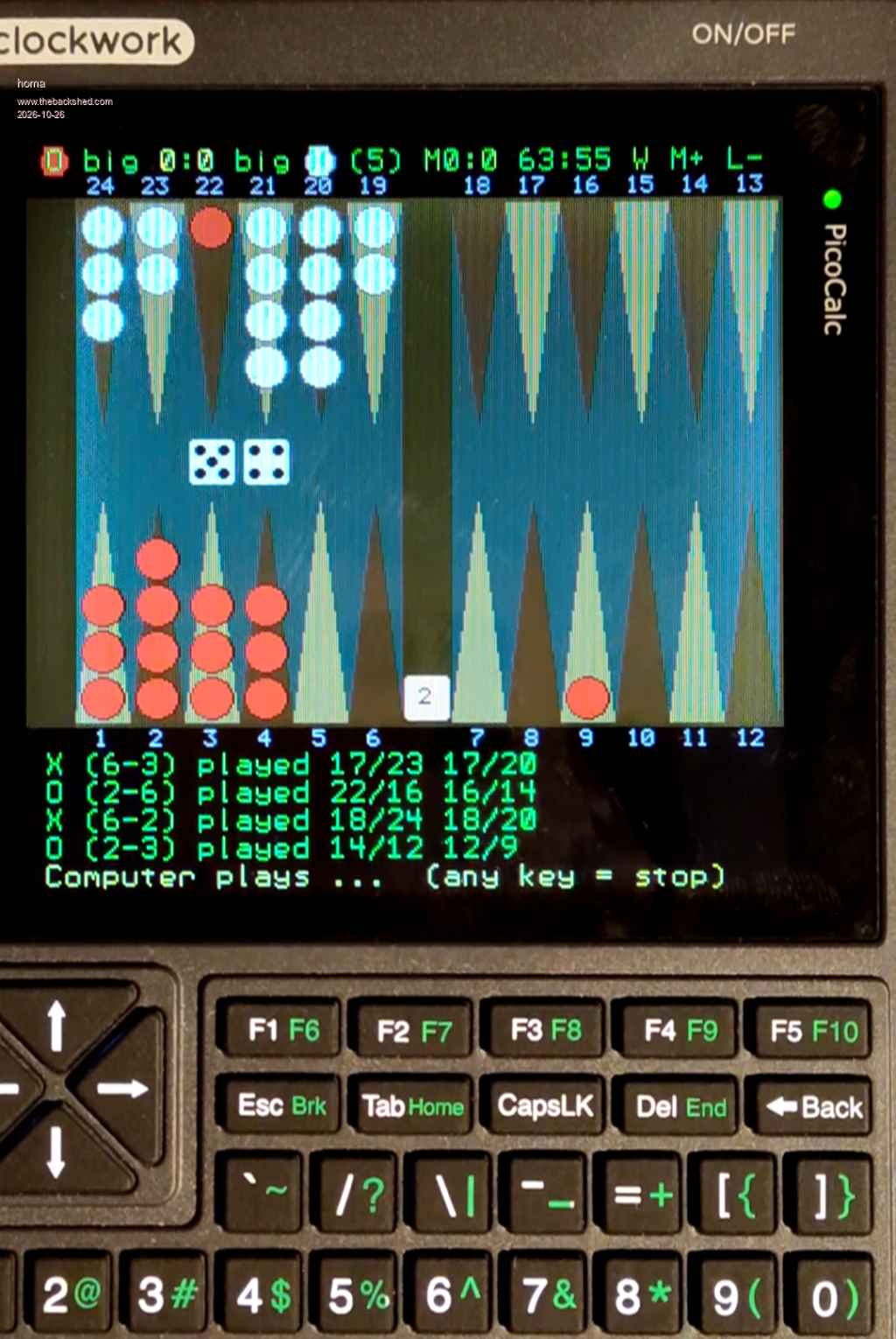

25 Oct 2026
homa
MMbg 1.10.34 – Backgammon for MMBasic, now also on the Colour Maximite 2 and the PicoCalc
A new version of MMbg is available. The program mmbg_pc3.bas now runs on both the PC3 and the Colour Maximite 2, and for the PicoCalc there is the separate edition mmbg_pica.bas.
New in this release
    Colour Maximite 2: firmware 7.00.00b3 or later with OPTION PICOMITE HDMI. Tested on a CMM2 G2 with a 10-hour turbo run (404 matches big vs. big) without a single error. The speed is similar to the PC3 (big ~0.6 s per move, deep ~10 s).
    PicoCalc (MMbg PiCa 1.10.33): the same game with all engines up to big and deep, for a Pico 2 or Pico 2 W (PicoMite / WebMite RP2350, V7.00.00 RC3 or later). Runs with RAM and SD card only – see below.
    PS/2 mouse: besides a USB mouse, a PS/2 mouse (channel 2) is also recognised. On the CMM2, plug a dual-mode mouse into the lower USB socket and set OPTION MOUSE 0.
    Enter key: CR/LF no longer stops a running computer by accident (the CMM2 sends CR+LF for Enter).
Setting up the CMM2 (only once)
OPTION MOUSE 0          ' only with a mouse in the lower socket
Then copy the folder mmbg to the SD card and start it:
CHDIR "A:/mmbg"
LOAD "mmbg_pc3.bas", C
RUN
There is no WLAN on the CMM2, so gnubg as an opponent (engine E) is not available. Everything else works as it does on the PC3.
Hint for 7.00.00b3: if you get "Could not find the file" when starting from the prompt, start mmbg_pc3.bas from the file manager (FM) instead. This works fine and appears to be a beta issue.
Behind the scenes: the big nets in the PicoCalc's small RAM
The big gnubg nets (contact and crashed) have 250 inputs x 128 neurons = 32 000 weights each. As floating-point numbers that is 256 KB per net, 512 KB for both. The PC3 keeps them in PSRAM. The PicoCalc has no PSRAM and only about 270 KB of free RAM after loading MMbg, of which the game itself needs a good part.
How it fits anyway:
    16-bit weights with one scale per input row: each weight is stored as weight = lo + u x q, where lo and q are taken from the smallest and largest weight of its row. One net shrinks from 256 KB to 64 KB (Pico 2 W). The Pico 2 uses 32 bit.
    Only the rows that are needed: in a real position only about 50 of the 250 inputs are non-zero, so each evaluation needs only those ~50 rows. Each row is processed with three fast firmware commands: MEMORY UNPACK, MATH SCALE and MATH C_ADD.
    Row buffer plus SD card: as many rows as the free RAM allows stay in a buffer (about 170 to 190 of the 250, with a 44 KB reserve left for the game). A missing row is read from the SD card in under 1 ms. A "clock" method decides which rows may be overwritten. In practice that means about 3 SD reads per second, and the computing time stays at ~0.5 s per move, the same as on the PC3.
Does the rounding cost playing strength? Checked against the full-precision evaluation of the PC3: over more than 3 000 positions the equity differed by at most 0.0012, and 679 of 680 move decisions were identical (the one exception: two practically equal moves swapped places). An overnight run on a Pico 2 W against gnubg 2-ply won 199 of 450 matches (44.2 % ± 4.6 %), compared with 46.7 % on the PC3 – well within the statistical spread. The PicoCalc plays as strongly as the PC3.
Videos
PC3:
https://youtu.be/x2N5_EjmmYE
PicoCalc:
https://youtube.com/shorts/c7xFFryiugg
Many thanks to Peter for the OPTION PICOMITE / OPTION CRLF support in the CMM2 firmware.
The full manual (English and German) is included in the zip file. Details on the packed nets are in Part 2, chapters P6 and P7.
Matthias
