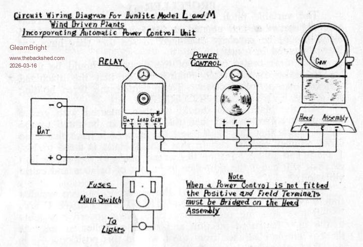

Attached below is the wiring diagram from the operating manual. My understanding is that a PWM controller and diode would replace the power control unit and relay as described. In the original unit, the relay is a combined 'selenium dry rectifier' (older equivalent of a diode) and the power control unit is a mechanical PWM device. I'm just not sure what PWM or diode specs to order, nor how to wire/configure it correctly.

mab1
A transformer isn't going to work as your unit is d.c.  (looking at old-dunlite's pics though makes me think that his unit is a 3phase alternator, which could be transformered to a different voltage).
I don't know anything about these units, but is a 32v unit is designed to operate on a 32v battery or just output 32v? Or is it designed to charge a 24v up to 32v?
Similarly for a 48v unit? Although i would tend to assume a '48v' generator is designed for 48v battery charging - i.e. up to 60v.
But taking the 32v and 48v at face value, that means you need to get an output 1.5 x design:
If the original blades were a low speed design, then a faster blade set might work.
Running the field winding at 1.5 x 32v (i.e. 48v) would mean field amps are 1.5 x nominal too. Assuming this doesn't drive the iron into saturation, that would raise the output voltage to 48v. But, it would also raise the winding power to 2.25 x nominal. Without knowing the field resistance (and therefore nominal power at 32v) it's difficult to say if that would overheat the generator of not.
Building a circuit to replace the original controller shouldn't be too difficult, particularly as your diagram suggests running without a controller is an option, but would need to know details such as field winding resistance, and max output amps.
Posted: 02:45am
16 Mar 2026
On old generators the stated voltage is the nominal battery voltage, not the charging voltage. So for a 32V unit the output would be 35 to 37V.
In the diagram above the Note says if no Power Control (voltage regulator?) is fitted the field can be directly connected to the output.
This opens up an opportunity as the DC to DC converter can do the regulating, so the generator output voltage no longer matters.
Same as a solar charger where the panel voltage can vary a lot, except using a boost instead of buck converter.
The Relay (reverse current cutout) would be replaced with a large diode. Either a Schottky or MOSFET Ideal Diode circuit for better efficiency.
Edited 2026-03-16 12:54 by phil99

Posted: 07:21am
16 Mar 2026
Given the warning in capitals and that the governor is how the the current is normally controlled, another means will be needed if you override that.
So instead you will need a voltage regulator that includes current sensing and regulation.
Early Holdens eg. EH had a Bosch 12V 25A generator with a regulator box that had 3 step proportional relays for both voltage and current, as well as the reverse current cutout relay.
You will need a solid-state equivalent of that.
Posted: 09:06am
16 Mar 2026
mab1
Ok, well if the existing mechanical variable pitch control is used, that should take care of max amps and mechamical overspeed, i guess.
Your table of voltage /amps limits suggests the max volts for this unit is 50v, which, (as i think phil said originally) is a bit low for 48v battery charging.
Just looking at field resistance: 27ohms at 32v is about 38w power dissipation in the field winding; 50v puts it up to 93w, so i would be reluctant to go past that.
So i guess that brings us back to running it at its nominal voltage and using a boost converter: if the output is 20a max, then there are some fairly cheap ones on Ali that should work:
40a boost converter
Although it can be run without a controller, i would advise using one, as it would reduce the risk of burn out, should there be a loss of load in windy conditions.
I've used a simple opamp as comparator circuit for alternator regulators in the past: something similar should work here. But the issue may be voltage stability if the output is not connected directly to a battery, as the field winding is a big inductor, the field current can change quite slowly, meaning the output current cannot change suddenly if a load suddenly drops out. A very large capacitor on the output may suffice, or a small 32v battery.
Edited 2026-03-16 19:08 by mab1
