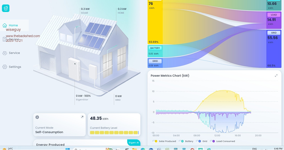

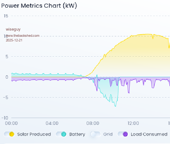

The Sig storage/inverter system has been in & operating, essentially beginning on 18/12/25.  I think its only fair to inform now about the negatives of a Sigenergy system and some of its internal workings and secrets. I was checking on our overnight consumption and was alarmed at how high it appeared.
First a bold statement. Overnight my 48kWh system appears to self-consume over 4kWh of standby power or close to 400W continuously, nearly 10% of overall capacity.This has nothing to do with phantom static loads of the house it is just what it requires to exist. So in a typical 24 hour cycle it consumes, I estimate over 8kWH of our solar bank consumption.
The Sig graphs gave the dirty secret away if you look carefully enough you see it. Overnight there is ~ 650W minimum consumption disguised as house standing load but curiously at ~ 7AM the house minimum standing power remarkably drops to ~ 200W then in the evening around 7pm it increases again back to ~650W.  The 7/7 time points align with the beginning of solar start and solar stop for this time of year. I could not understand why the 650W dropped by around 400+ watts before the solar appeared to start in the morning, then I started to realise what was going on & the reverse at dusk. Why was the standing 650W dropping to 200W before the solar appeared to begin?
The energy consumption is hidden in the daytime as the standing inverter self consumption appears to be robbed from the solar energy created before it actually reports on what is the resultant solar generation (ie what is left after we remove ~ 400W from the actual solar generation).
So a check with Mr Google and the first hit revealed some interesting information.
"There was a post in the Sigen app community about a week ago commenting on this. One user suggested 60W for the inverter plus 35W for each 8kWh battery module."
I knew there would be some inverter standing loss and 60W sounds slightly plausible albeit on the very light side for a 25kW inverter, the real shocker (pardon the pun) was for the 6 x 8kWH battery stack to be using over 200W continuously over-night. Some other Sig information on the Web mentions BMS and Battery monitoring and balancing power consumption as the cause.  Do we need a balancer overnight when not charging & surely monitoring and BMS should draw less than 5W.
I believe what is going on is that the 32V to 600V converters running continuously in each module is chewing up the extra 30+ watts per battery module.  This tells us that the overall trip from batteryV to mainsV ie inverter idle current is really around 400W. I am unsure if the 35W per module was calculated/derived/assumed from the total energy on the HV "bus" to the inverter, divided by the number of battery modules or if the standing current per battery module also increases proportionally for fewer battery modules ?
Sorry for the longish post but if considering a Sig system, be armed with some hidden detail of what is going on internally. Nearly 10% of your battery capacity is not available as it is eaten when the sun isn't shining, and when the sun is shining it takes ~ 4kWH of consumption before you ever see it.
Here is a picture of the Sig information graph. The green is battery energy being used, the lower purple is shown as energy for the house. Look at 6am and you will notice a decline of battery energy supplied to zero at about 7:30 as the solar is now reported to have started generation.
The decline in battery energy is caused by the true beginning of solar energy from the panels from ~ 6:am.  The 300W house consumption shown was a snapshot of the graph during a house minimum load during solar generation.
Zoomed in: The house load (violet) & battery energy required (green) magically drops from 650W to ~ 200W before solar supposedly "started"!
Battery was fully charged before 11am.

Within 3 days bedlam on Facebook Marketplace, today there are 71 Fronius inverters available in Adelaide from $75 to $2,600 !  The total number of inverters at a quick count is 191!  All the high priced ones will get a good reality check very soon, I reckon if they get ~ $50 scrap value for one they should be thankful. Just a few years ago a Fronius price was in the thousands. Is this happening in other states?  There should be plenty of ring cores for inverter chokes to be had very cheaply in the near future.
