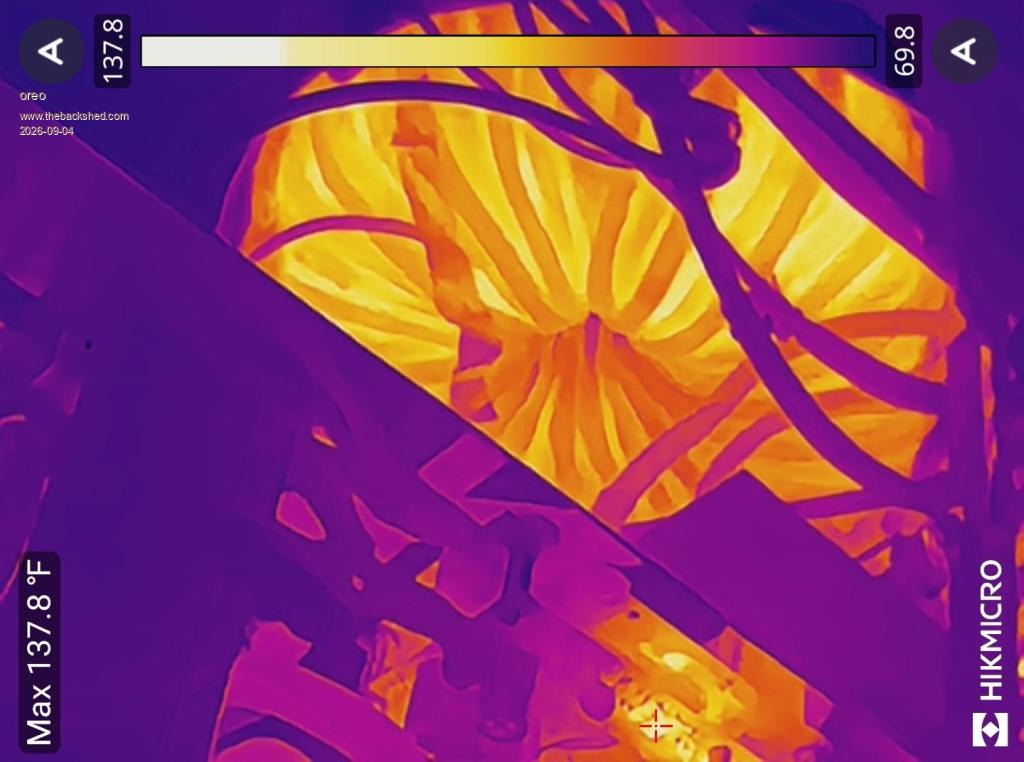

Power testing on the transfomer shows a temperature rise of 36C at 5100va to the load (sensor measures a 22C rise).
Not sure how hot the inner windings might be getting.
I think on the next transformer, I will bury a temperature sensor.

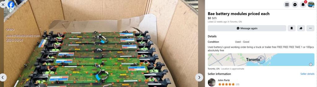

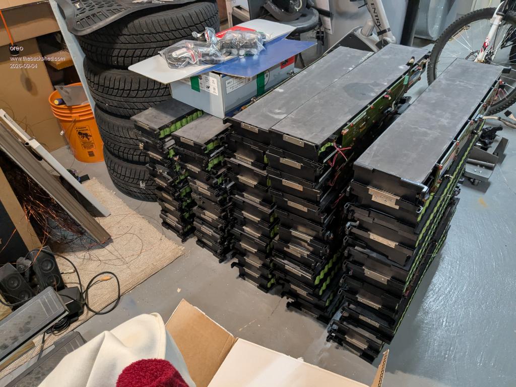

So I had decided a while ago that it was not cost effective to add capacity to my current battery bank
(currently about 14kw using 24pcs of 36v packs using A123 26650 cells).  Batteries are expensive and 14kw gives me about 1 days storage.
Then I saw this marketplace advert.
So yah, I had to pick up some.
I spoke to the people giving away the batteries, and they said that they had over 1000pcs in stock and they were not selling.
 Apparently they are expecting to get some all electric busses in for tear down and will soon have better batteries to sell (these batteries are out of hybrid busses)
