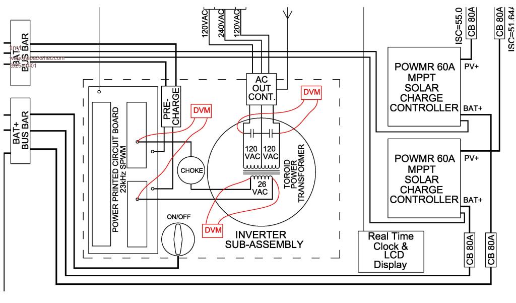

Sounds like you are measuring this in the Inverter, so that's likely a bit of switching noise skewing the VFB sense or slight distortion on the AC VFB from the load ETC, so the load to unload comparison may be a little off.
Measurements are in the inverter at the points shown in red.
You are probably correct about the waveform distortion with load and without load which affects where the EG8010 is sampling it.
  KeepIS said
Is spwm = duty cycle spwm %  (if accurate) it's extremely low?
It is not the duty cycle I just labeled it spwm, it is the ac voltage reading from the fluke DMM, see figure above.
  KeepIS said
Very nice build by the way to fit all of that in a relatively compact space.
Thanks. It is a rat's nest inside and it is still a work in progress. I am still struggling with the arduino coding for all monitoring and controls.
And I also still have to learn how MQTT and Home Assistant work.

So, I used a Fluke 179 and took actual voltage measurements:
No load:
Secondary(L1-L2) = 236.6vac
Primary = 26.16vac
Primary including the choke = 31.9 spwm
Calculated turns ratio: 236.6/26.16 = 9.044
L1-N loaded with 120vac pool pump drawing 7.6A
Secondary(L1-L2) = 237vac
Primary = 26.37vac
Primary including the choke = 32.5 spwm
Calculated turns ratio: 237/26.37 = 8.987
Note that no load voltage output is lower than with load. We noticed this on the 3 inverters that I built.
Thanks for doing the measurements.  So, the main takeaway for me is that it's possible to achieve very high surge power with a relatively small/lightweight transformer core with a little larger winding gauge and a ~2x power stage board.  This is encouraging.

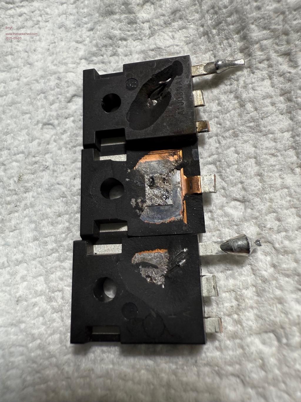

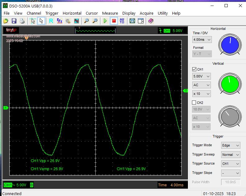

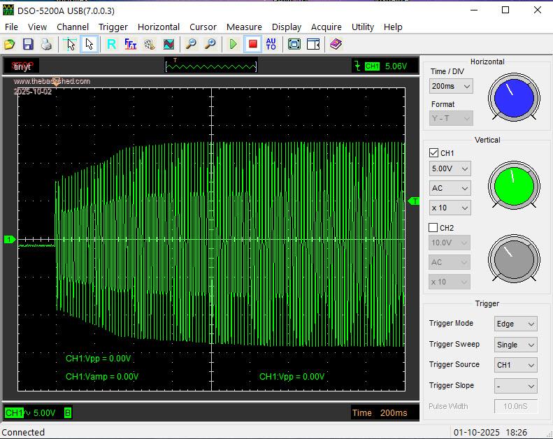

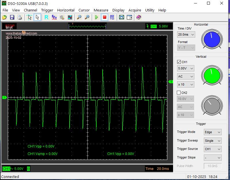

Just an FYI update:
The power board is fixed. All 24 mosfets were replaced together with their totem-pole drivers. Two gate drive diode 1N4148 were tested to be shorted and they were also replaced. It is now running and the voltage readings I posted earlier were taken from the inverter with this power board.
The soft-start module came and I tested it using a small step-down transformer for the load. Input is grid(mains/street power). The scope probe is at the low voltage section of the transformer. Trimpots on the module were re-adjusted for arbitrary start-up voltage and ramp delay.
Edit: Earlier pictures that showed zero crossing anomaly is no longer present with additional heating element load in parallel with the small transformer. Pictures are now replaced.
(Output waveform after delay in the first picture shows triac zero crossing discontinuity?) <- No longer relevant.
(I think the delayed bypass relay is really needed so that the compressor will not run with this zero crossing anomaly.) <- No longer relevant.
Will test it using my small air compressor induction motor later.
