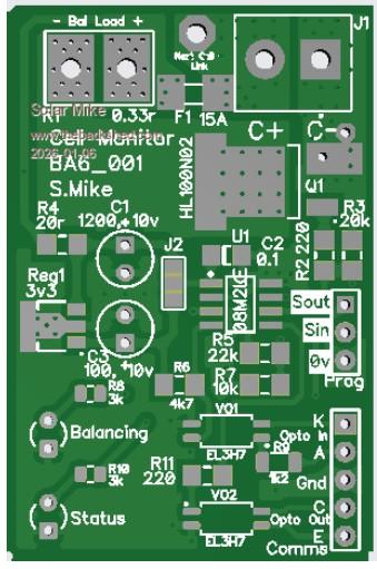

The 1-Wire communications setup may be of interest, it is based on a 12v logic "wired OR" system, having a large hysteresis to get noise levels down. The Master device supplies 12V,0v power to the slaves, with data isolation by opto - couplers. 2 way control bus floats at 12v when not active. Schematic: ![]() PCB 33 x 40mm: ![]() ![]() Gerbers: 6 pcbs fit on a 100x100mm board, I get them made 1.2mm thick and cut with a very large tin snips 1WireV4Gerbers.zip Cheers Mike Edited 2026-01-10 20:56 by Solar Mike |

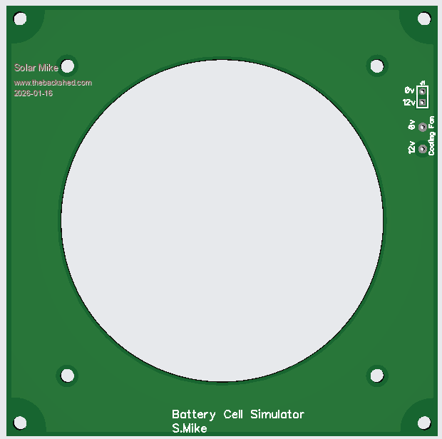

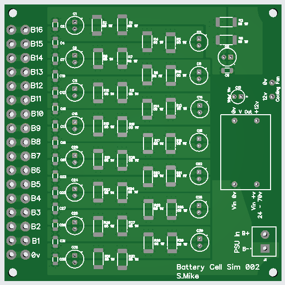

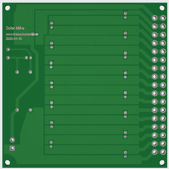

To initially set the balancer up, in the past, I have used a pcb with 16 series W.Wound resistors each with a capacitor, all powered from a current limited PSU. This simulates a 16 cell battery and is easier to manage on the bench rather than connecting to a live battery bank. Was a bit messy, so have decided to use a new board using accurate 0.1% 1 watt resistors and a small cooling fan. The current is just over 100mA and provides a reasonably accurate cell voltage that can be easily varied by the PSU for testing. Here is the design for that, 100x100: ![]() ![]() Fan PCB, sits above the main board: ![]() Cheers Mike Edited 2026-01-16 16:43 by Solar Mike |

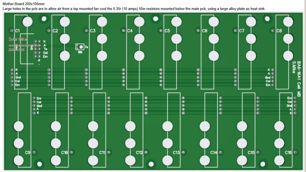

More progress, the high current switch pcb's arrived today, so will make up a board and do some tests over the next week or so. Back to the original topic, I have made up the 16 small cpu based cell modules that fit atop the main carrier board. ![]() Have been waiting for replacement right angle 2 pin connectors to arrive, originally made the modules for straight connectors... and after fitting a couple for testing, you cannot do up the socket screws, bugger! (Kiwi Expression); anyway have made them up now with the new connectors. These little pcbs take forever to build and I need another 64 for this project, so I think a re-design maybe is in order (new topic pending). Will get this lot going, software is almost completed, well it works 100% with 2 modules, and use it on my small battery bank for the EV charger. Host board: ![]() The vertical pcbs soldered to the main board with RT angle pins, don't have room to screw up the terminals. Cheers Mike |
