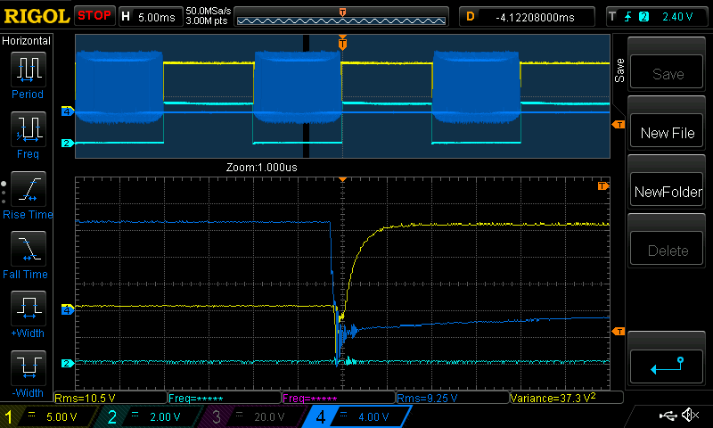

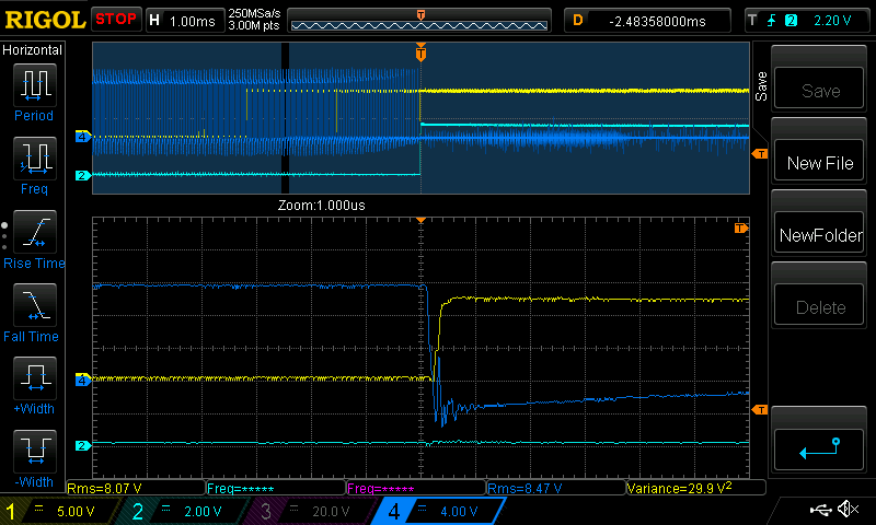

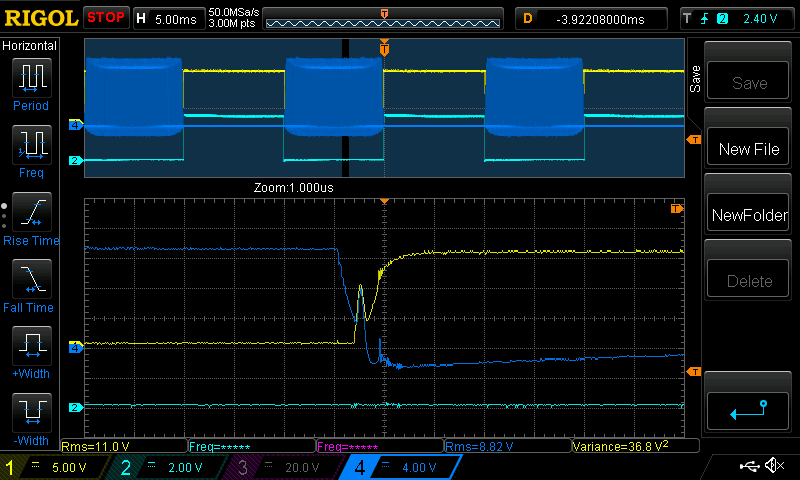

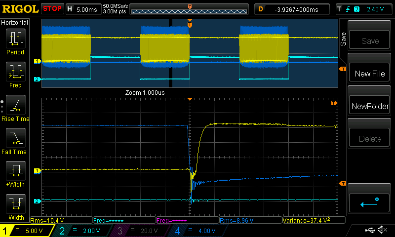

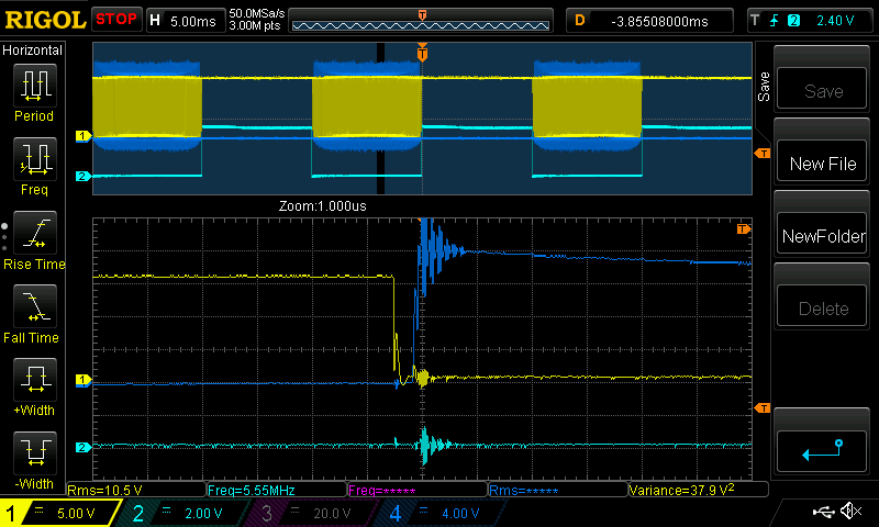

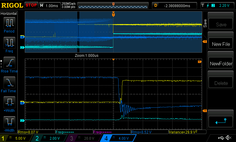

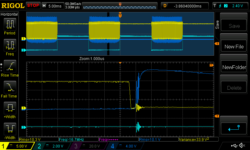

I made some RC snubbers for both low and high side across all 4 FETS. I was guided by this: https://assets.nexperia.com/documents/application-note/AN11160.pdf after a test with a cap on the high side drain/source pins I got "maybe try 3 nF and 5 Ohms" I have 2.2nF and 5 Ohms here. So I put this on all 4 FETS Each FET had this RC snubber connected drain and source. not a lot of ringing any more... colours are now Pink is low side gate voltage dark Blue is high side gate voltage Yellow is half bridge voltage - that is one end of the output going into the primary winding. light Blue is just the 50 Hz sync pulse - notice it gets some disturbance? crosstalk of the scope inputs I think ![]() I could tune it further, to get a bit more damping. this is a large step in the right direction. I need to read your post Wiseguy next and this will take some time. |
After looking more carefully at all your CRO waveforms what I see looks identical to the ringing curse that usually occurs with paralleled FETs, and sometimes but less severely in a single FET. There is a feeling of deja vu to me. I spent hours trying every "cure" I could think of - similar to what you are doing. I found snubbers very ineffective for that HF ringing they may have modified or reduced it slightly but that was it. The only effective cure I found was putting a ferrite bead on the drain leg. Note with multiple FETs insulating pads must be used for each FET with a bead, they cannot share the same heatsink uninsulated despite all being at the "same" potential. All that does is short the beads out and they don't "bead" any more. It is also easily seen in some of your images that higher values of gate resistance can cause the lower FET to briefly commutate to on when the high side turns on. I agree that switching the FET more slowly does not seem to kick start the HF bursts of oscillation but has other negative effects. Maybe the slower switching helps to quench tendency to oscillate due to being in its slower & resistive switching region? With higher values of gate resistance the FETs do turn on (and off) more slowly, spending more time in their "linear" region, generating more losses - heat mainly. Lower values of gate resistance cause the FETs to switch more rapidly which also can tend to generate more radiated noise. I should add that my comments and results were all with my hardware so results might vary. I look forward to the next instalments ![]() PS Your last post with image, the dark blue gate appears as classic gate "R" too high as it was commutated off whilst trying to turn on - due to miller I assume? The upwards blip of the yellow trace I interpret as some of the L energy being released back to the half bridge node during the momentary turn off. Edited 2026-02-17 11:49 by wiseguy |
yes, the dark Blue high side gate voltage trace seems very bad now. I put 4R7 gate resistors on the board for all 4 FETs since the smaller ones seemed to be a bit too fast. just to clear up one thing, no FETs are in parallel. Seeing the wild changes in high side gate voltage, I retested without the isolated probe, this time just a 10x probe, referenced to DC GND. I saw the same thing. Maybe I go back to 2R2 resistors, to help a bit with that high side gate voltage dip. I read your views on low side gate being turned on by capacitive coupling of low side drain going through fast dV/dt events. once low side gate gets this voltage, it has to be sunk via external parts. Interesting that HY4008 has an internal gate resistance! shorting the pin still means it's at best 3.2 Ohms. that will take some time to dissipate the charge created inside the chip. A follow-up on past question: yes I tested with one of your first completed 2 x 4 FET inverters. I thought that it was an interesting test due to your having SMD FET totem pole driver close to the FETs. This project is not intended for widespread use by others. I want a simple unit, maybe for the camper. I think we might find a solution that will be adequate and cheap and easy to build. But it is to be robust. At idle (no load) there is ZERO shoot through. this indicates to me it will survive. |

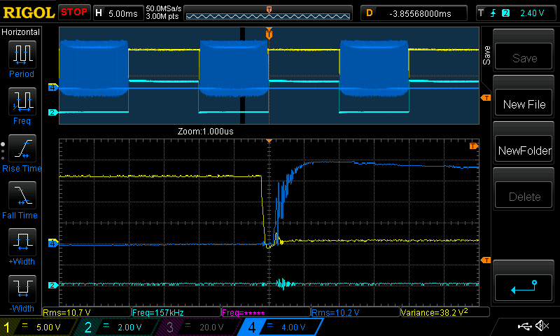

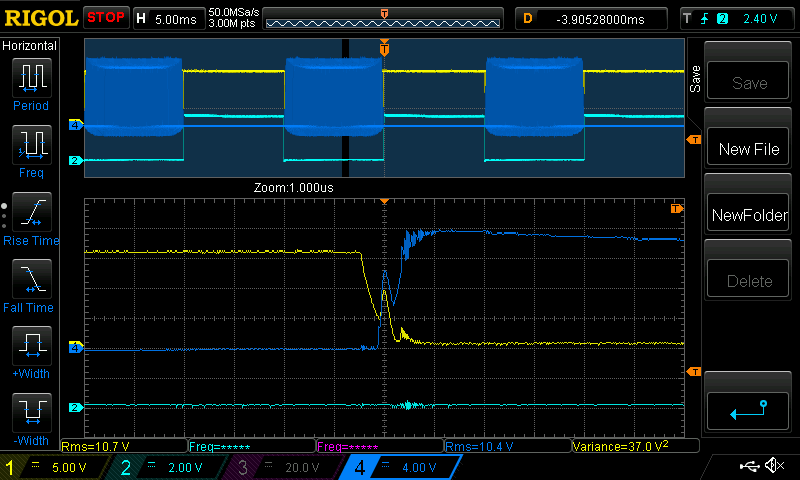

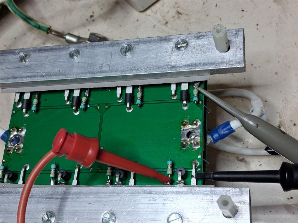

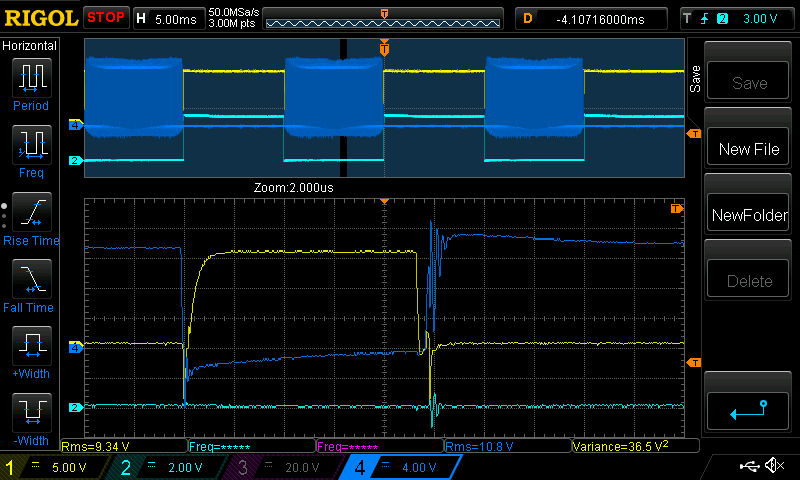

I was wondering if my voltage probe technique might be dodgy. In particular, the un-shielded 2 wires that connect the high side Gate and Source that then go into the isolated probe. my question was "is this voltage real?" I took 2 DC ground referenced DSO probes, put on on the high side Gate the other on the Source and used the DSO math function to subtract the Gate from the Source. good news for me is both probe techniques work well and agree with each other. But what is going on here? ![]() Yellow is high side Source or the output of the half bridge. This is the "zero point" for the high side FET Gate to work against to turn it on or off. Dark Blue is high side Gate. these are the 2 lower traces. Purple is the isolated differential probe and the very stepped dark Blue is high side gate minus high side source, i.e. what the gate is seeing and it should be the same as the isolated diff. probe output. there is maybe 10 ns delay for signals passing through the diff. probe and we can see this here. Yes, both Gate voltages agree. But after the high side FET is dragged up to DC supply, the gate voltage drops to near zero. This is very interesting. The near zero gate voltage (implying to me the FET is not conducting positive current FROM Drain to Source but is sort of open circuit) might explain why oscillations can be initiated and/or sustained. This test was when under 200 W AC load, when the high side FET switches on. I do not care too much what is happening to the low side FET, no doubt it has turned on during this curious time too, just to make it even more opaque for my understanding. |

Based on your previous scope capture: ![]() the high side gate dip looks like the result of low side false turn-on (~3.5V). I believe you took out the gate turn-off diodes for these scope captures. If so, I suggest putting them back in. |
I think what you are seeing here is the drain to gate capacitance of the upper mosfet working against the gate drive current during the mosfet turnon transistion. The gate voltage increases untill the mosfet starts turning on, then when the drain to source voltage is rapidly decreasing the gate drain to gate capacitance driven by the gate drive circuit is working as a very fast Miller Integrator. The gate voltage drops back down to the mosfet threshold voltage while the mosfet is running in linear mode. As soon as the mosfet is fully turned on, the gate voltage again rises to the voltage provided by the gate drive circuit. |
