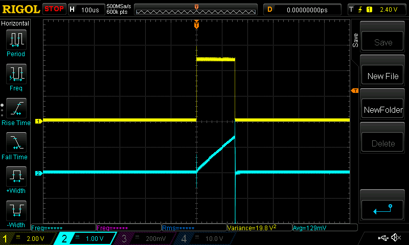

good going Bryan
If you find even a little choke that uses a ferrite core, you might be lucky and
get the sort of result I got (a straight line then increasing steepness).
Don't worry if your results look different to mine.
Ferrite cores are way different to the very thin laminated Iron core that you are testing now.
I just tested a large Aerosharp choke with 6 turns.
the current curve looks just like yours.
The Purple trace is voltage and it drops 3 volts, down from the 12V start point
during the pulse.

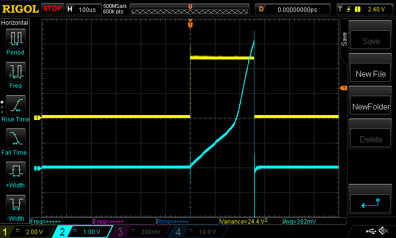

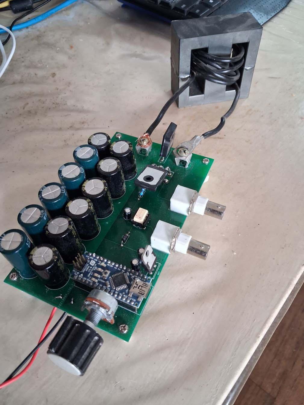

Bryan1
Well decided against taking the choke out of my inverter as down the track I will be building another Madboard and they can be tested then.
Awhile I played with one of those Temu induction heaters where I did manage to let the magic smoke out with my copper coil mod's
Anyway decided back then to build my own which became one of those projects to finish and went into somewhere in the shed
Found the toroid I made for the project so decided to give it a test.
This is the 210us pulse which works out to 10.5uf and 240A
The 310us pulse which works out to 12.45uf and 300A
The 400us pulse which drops to 2.4uf and 205A
So may be time to get the second one made and revisit this project.
Regards Bryan
Posted: 01:54am
01 Jul 2026
It looks like your capacitor bank is running out of charge after 50µS with such a low inductance.
To get a better look at what that inductor is doing perhaps reduce the pulse width to 50µS and set the scope time base to 10 or 20µS/Div.
