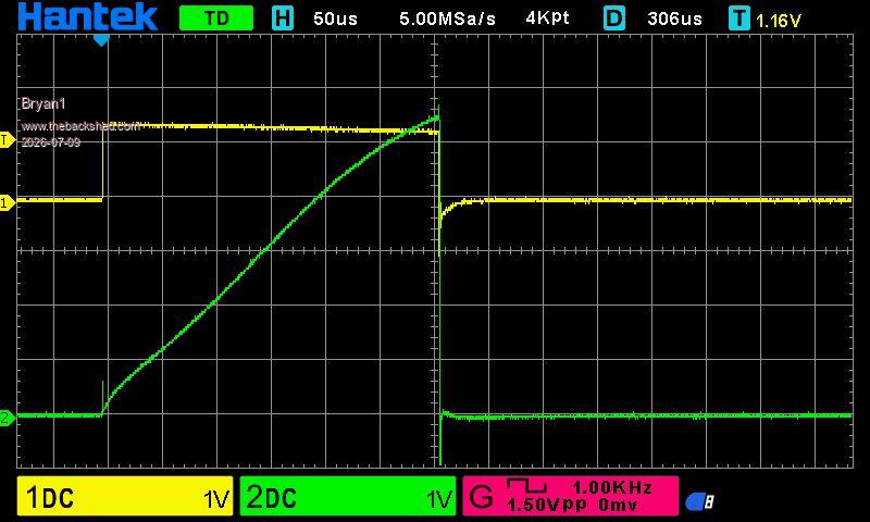

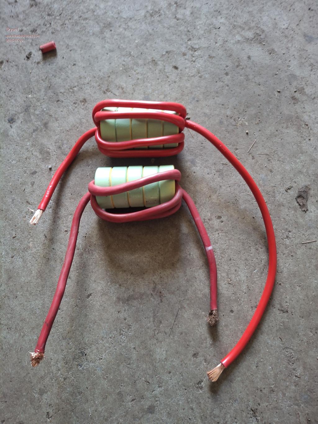

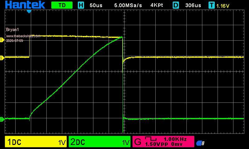

Well went for drive in this morning and got somemore 6AWG wire and wound the second choke
Now I retested the first choke
Then tested the one I just made
So for me it's close enough for a matched pair

Bryan, just a few questions if I may to make sure everything is in order:
What is the power rating of your shunt resistor? Can you confirm that it still measures 0.02Ω? - assuming that is the value you used.
The shunt should ideally have very large bolt terminals right at the shunts resistive element, and virtually no lead length. IE: very heavy short copper to the FET, and the same to ground, and the Isense + and - leads taken from straight across the resistive elements terminals as close to the body as possible, otherwise the readings will be incorrect, especially for high current chokes.
Posted: 04:32am
09 Jul 2026
Bryan1
Keepis the 0.02 Ω shunt resistor is a 5 watt one and it's about 8mm away from the fet
Now measuring in circuit the measurement I got was 0.14Ω and I did measure the resistor before putting it in and it was 0.02Ω.
now I got my old fluke 865 out and the shunt resistor did measure 0.025Ω so I do believe that against this chinese scope DMM anyday.
Edited 2026-07-09 14:57 by Bryan1

A 0.02 Ω resistor with a 300A pulse has the potential for 1.8kW and 6 volts across that resistance.
The resistive "shunt voltage drop" must be read directly across the resistor terminals, or right at the body of the resistor if it has legs (through hole mounting).
You might need a real shunt when testing at very high choke currents?
I have never measured what a momentary, extremely high current Pulse-Shock does to various types of small resistors.
This is why I prefer a 500A (measures 0 to 700A) Hall Effect Current sensors instead of a large shunt, they actually cost less then most commercial resistive current shunts.
