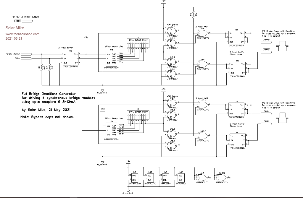

AS described, this topic is to show differing circuits for inserting the required dead time into the 20kHz spwm and 50hz signals for driving opto coupled H-Bridges.
There are a number of forum members designing new synchronous modular H-Bridges, myself included, so I thought I would present a few dead time generators that can connect direct to the IO pins of the CPU and create some discussion as to the best way to do it.
My inverter needs a single cross-coupled drive signal for its simulated opto inputs on each 1/2 bridge; the 1/2 bridges can be paralleled to increase the output power, so I could have 3-4 wired together.
Each opto signal needs 8-10 mA, thus up to 40 mA drive current from a totem pole type driver, normal logic gates can manage perhaps a single opto, certainly not 4.
This design uses the mini logic gates in the output each with 32 mA drive, so 2 gates in parallel will happily do what I want.
I looked at having one or two RC networks as the dead time delay, but having used this on previous designs, its easy to setup with the right test gear, BUT its not repeatable, the delay timing varies with temperature and the IC being used, so have rejected the idea of RC delay for timing.
There are a number of silicon delay lines available that have taps where you can select what delay is required and they are accurate.
This design used two delay lines, one for each 1/2 Bridge signal. The delay is inserted in the trailing and leading edges of the pwm by action of the XOR gates, the following NOR gates act as an inverting buffer and Enable input.
Though I could put something like this on a small pcb that plugs into the main CPU board.
BridgeDriver.pdf

Posted: 10:34am
21 May 2021
If you are still planning to use opto couplers (a good idea) there will still be some random differences in opto delays with time, temperature, manufacturer etc...
I still like the cross coupled inverse LED driver circuit with a dead time capacitor, plus you get shoot through protection for free.
Posted: 11:01am
21 May 2021
Solar Mike
  Warpspeed said  If you are still planning to use opto couplers (a good idea) there will still be some random differences in opto delays with time, temperature, manufacturer etc...
The newer simulated opto couplers that am now using have no where near the random differences as exhibited by the old style opto's, they are extremely close in tolerance between devices and hardly affected by temperature variations.
When multiple half bridges are paralleled, having multiple capacitors each with a differing timing just exasperates the problem, great if just a single H-Bridge is being used.
Mike
Edited 2021-05-22 09:00 by Solar Mike

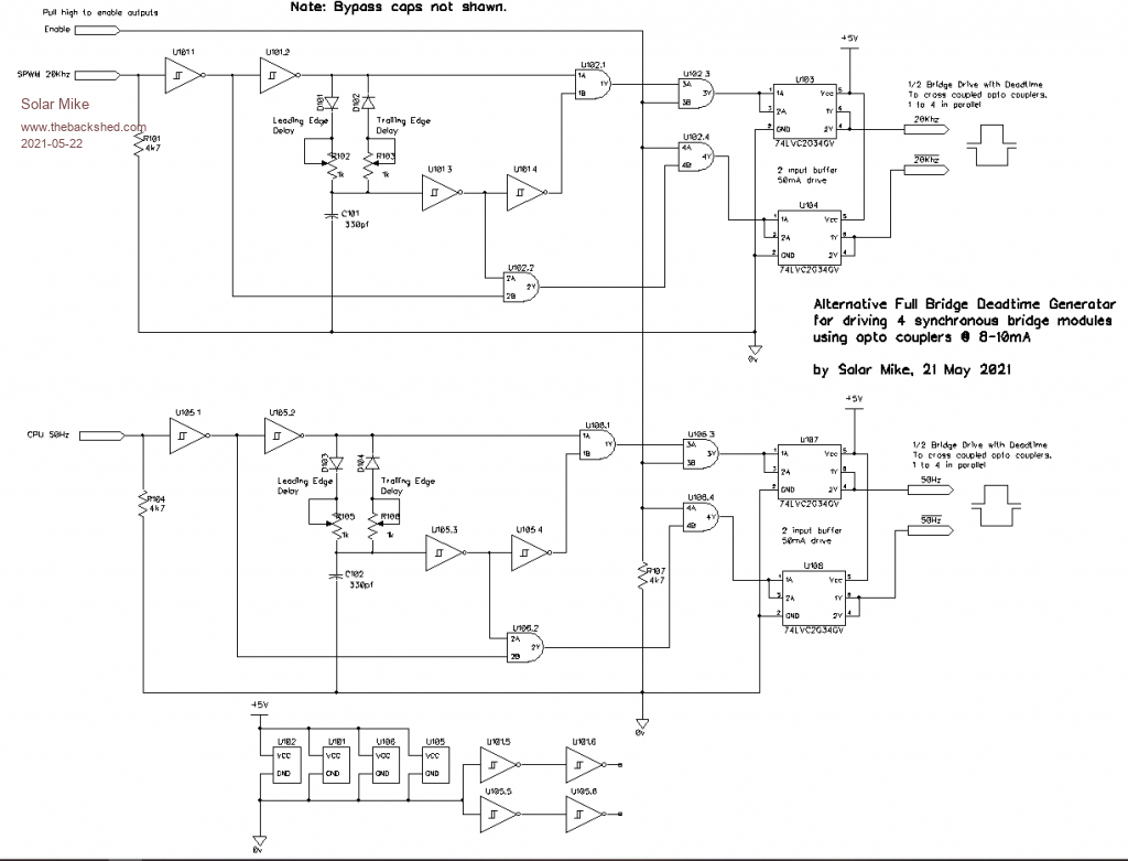

Here is another alternative, simpler than the first delay line example, using a single RC delay with independent adjustment of leading and trailing delays, and the components are cheap.
It is not repeatable in that every build would have to be setup with a scope for the correct timing; which will also change with temperature.
Mike
Posted: 10:21am
22 May 2021
tinyt
How about using COG/NPO dielectric capacitors to minimize drift due to temperature. Maybe drift introduced by the diodes can be compensated by PTC or NTC resistors.
Posted: 11:48am
22 May 2021
Solar Mike
  tinyt said  How about using COG/NPO dielectric capacitors to minimize drift due to temperature. Maybe drift introduced by the diodes can be compensated by PTC or NTC resistors.
Good point, there is also the schmitt trigger trip points changing with differing devices.

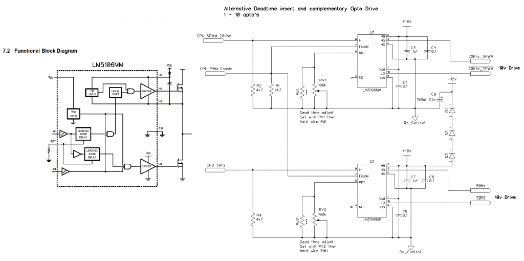

Have spent last couple of hours looking for a single chip solution that has a good adjustable range in dead time settings, the modern isolated drivers like the Si8234BB-D-IS1 series would be ideal; BUT no one has any for sale, everything is on back order until the end of the year or later, I have some here but they are the faster H versions that I use in the PV controllers and wouldnt be suitable.
The only chip I can locate that IS actually available to purchase is the LM5106 , this older inexpensive device would work well as it has a range approx 85 - 550 nSec by altering a resistor, powered from 12v source and under voltage lock out.
Presumably the upper H0 VB can also be also powered from the 12v supply and Hs pin to 0v, this is unproven as they may not be on separate dies inside the package.
Element14 have them in stock, however have to get $50 worth to get free shipping, so would have to wait awhile on those until I need more bits, or locate an alternative supplier.
Mike

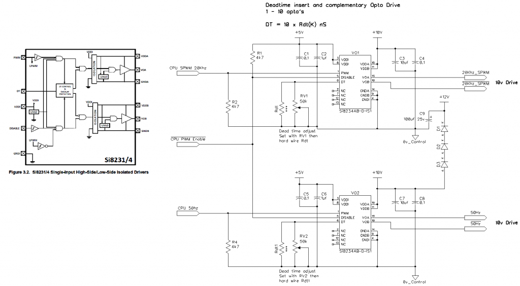

Posted: 09:54am
31 May 2021
Solar Mike
Will make this as a small module for plugging into the CPU controller board.
As the chip shortage worsens, its getting impossible to get anything exotic, so will create two modules with different components, should some become unavailable.
First build uses the Si8234AB-D-IS1 driver for the variable dead time generator, this isn't my preferred device, but none of the others are available until 2022.
Mike
Posted: 11:27am
31 May 2021
Solar Mike
2nd version uses the LM5106MM, these seem readily available at the moment and quite cheap. Enable input is Active High, other is active Low, will make them both 1 = on in final build.
Mike
